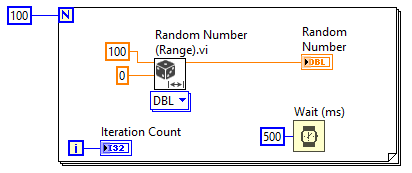

  1. Right-click on the count terminal and select Create Constant to display a numeric constant.
  2. The count terminal dictates how many times the subdiagram is executed. Input the number of times you want the loop to execute into the count terminal constant.
    • For example, by inserting 100 into the numeric constant, the for loop executes 100 times before stopping.
  1. Monitor the number of iterations the loop has undergone by right-clicking on the iteration terminal and selecting Create Indicator.
The image below shows a For Loop in LabVIEW. The count terminal is set to 100, so the code will execute 100 times before exiting the loop. In each iteration of the loop, a random number between 0 and 100 is displayed to the user every 500 ms. The iteration terminal increments with each execution of the loop.

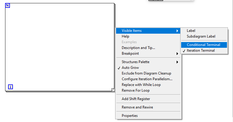

  1. Right-click on the edge of the for loop and select Conditional Terminal (On LabVIEW 2025 and further, the Conditional Terminal was added within Visible Items option):
    • You will notice that count terminal now has a red glyph and a conditional terminal (i.e. stop glyph) was added in the lower right corner.

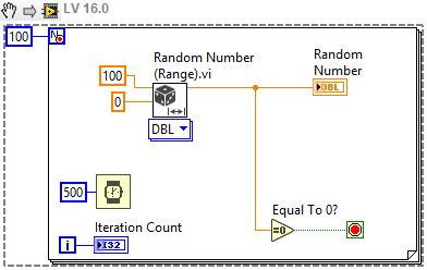

  2. Add in the code for which you want the for loop to stop executing:
    • This could be based on user input (e.g. a stop button, front panel value change, etc.) or based on programmatic analysis (e.g. input value measurement reaches a threshold, an error occurs, time elapsed, etc.).
The snippet below shows the code as described in the Build a For Loop section above with one exception - a conditional terminal is added. This code stop executing if the random number generated is zero or if the loop has gone through 100 iterations -- whichever comes first.
