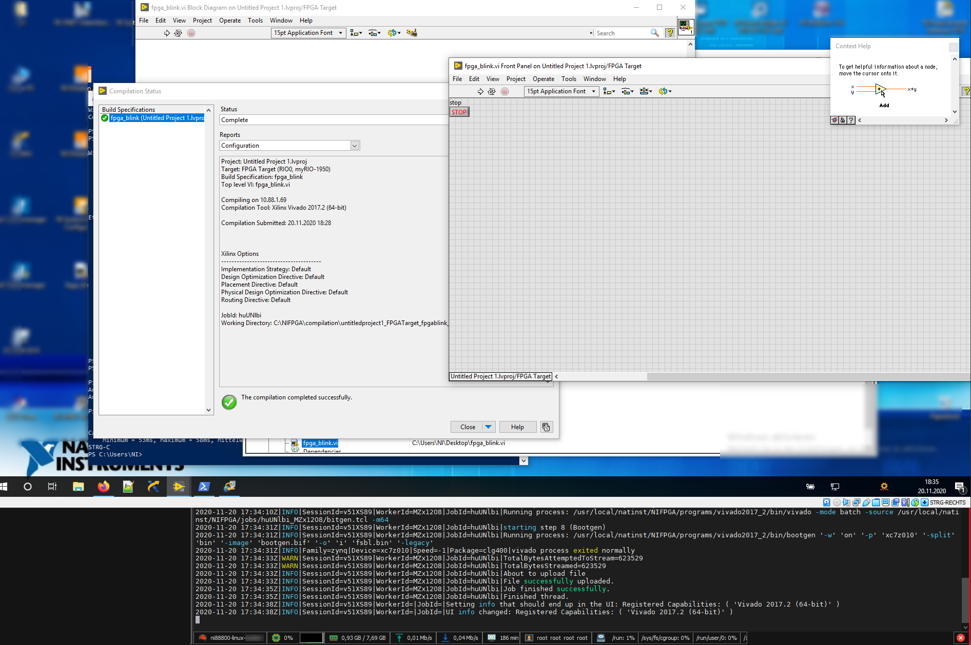

  1. Make sure the CompileWorker registered properly with the Compile Server. It should show up on the Worker list at http://<compileserver_IP_adress>:3582/WIF.html#/NationalInstruments.WIF.FpgaCompileFarmWifExtension;component/FpgaCompileFarmWifExtensionPage.dyn.xaml (edit the link to point to your server's proper IP adress. you will need Microsoft SilverLight to see the page)
  2. Screenshot of a properly registered CompileWorker.
