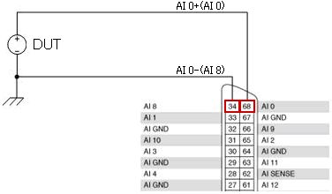

There are two types of signal sources: a grounded signal source whose ground is common with a system ground such as a ground or a building, and a floating signal source connected only to the system ground. The wiring method for each device is shown below. Connection method for measuring grounded type signal source The connection method when measuring the grounded type signal source is as follows. When connecting the grounded signal source and the data acquisition device as referenced single end, different grounds are directly connected on the signal source side and the data acquisition device side, so a ground loop may occur and the correct measurement can not be performed . Therefore, this connection method is not recommended.
  • Connection to grounded signal source in E series, M series DAQ
Figure 1. Differential input on E series, M series DAQ
