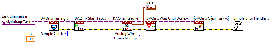

In LabVIEW, the task can be directly wired to DAQmx Timing VI (after being dragged and dropped from NI MAX to the block diagram) as shown below. The DAQmx Create Task and DAQmx Create Virtual Channel VIs are not necessary because the task and channels have already been created in MAX.

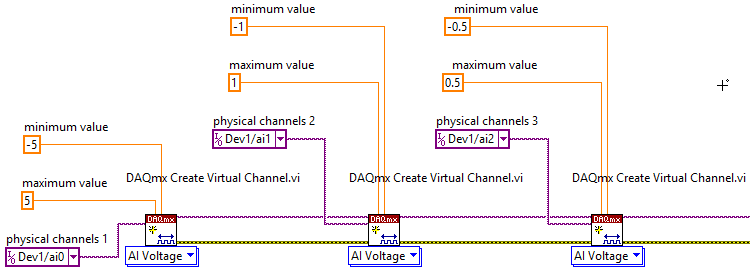

    In LabVIEW, the assignment of different input voltage ranges to analog input channels can be done by using multiple DAQmx Create Virtual Channels VIs to create different channels and set different analog input voltages for each channel or the DAQ Assistant.
    Using Create Virtual Channel VI:
    1. Place a DAQmx Create Virtual Channel VI for each channel to be set at the same analog input range. To select multiple channels for one VI, use channel expansion.
    2. Connect relevant terminals for the physical channels and other settings. To set the lower boundary of the analog input range, wire a double value to the minimum value input terminal. To set the upper boundary of the analog input range, wire a double value to the maximum value input terminal.
    An example of this is shown below.
