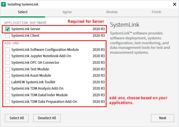

  2. Upload SystemLink offline installer to ECS and install it

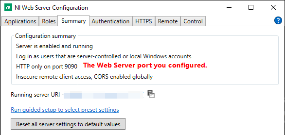

  1. Configure NI Web Server on the ECS, refer to NI Web Server 18.2 and Later Manual - Configuring NI Web Server .

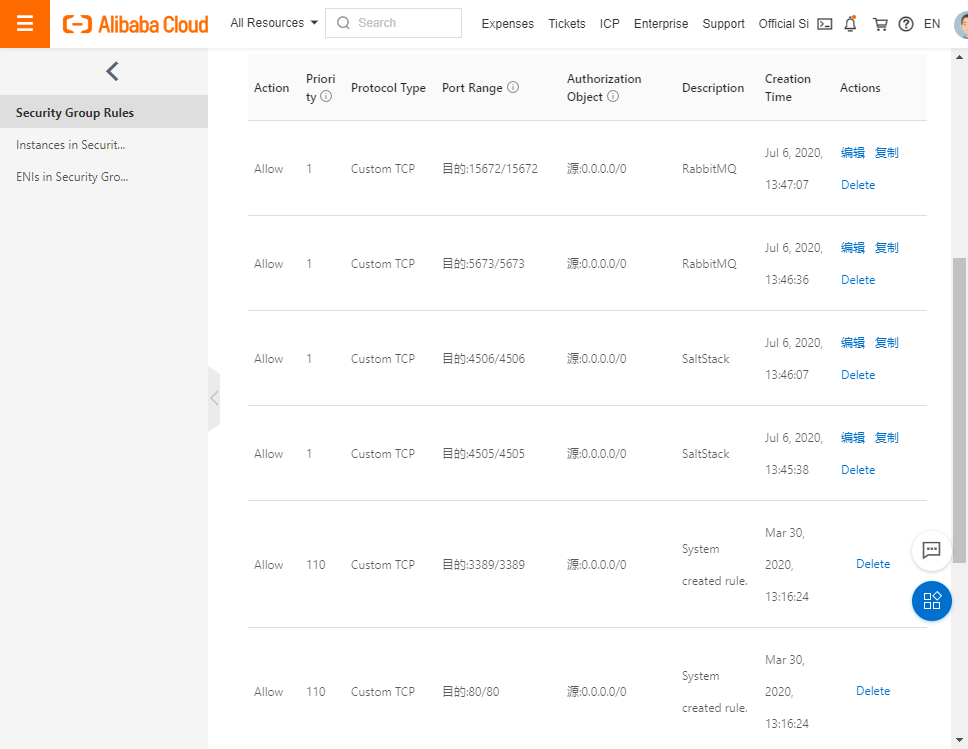

  2. Setting up ECS instance security group rules
    • Check required ports based on the add-on you installed, refer to Setting Up a SystemLink Server for port list.
    • Log in to ECS instance console and open the required, refer to External Link: Add security group rules.
    • Note, sometimes the network port may not available after the creation of ECS instance security group rules, please open the 8080 at the same time when you are in this situation.
  3. Test the SystemLink server with the ECS public IP and SystemLink server port which you configured in NI Web Server.

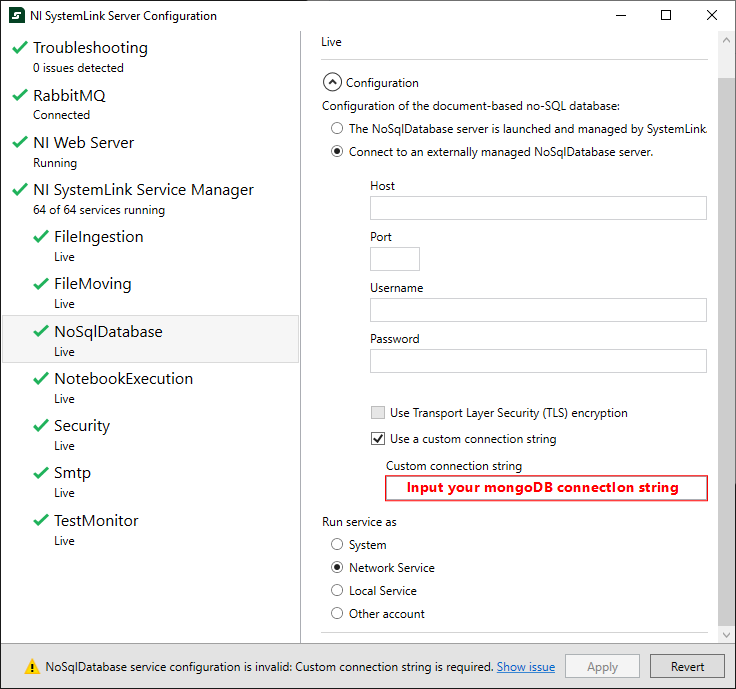

Optional Steps for Connecting Remote Sources to Enhance Scalability and Fault Tolerance
