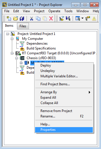

1. Once the module has been added to the Scan Interface, as shown in the image below, right-click on the module, then select Properties.

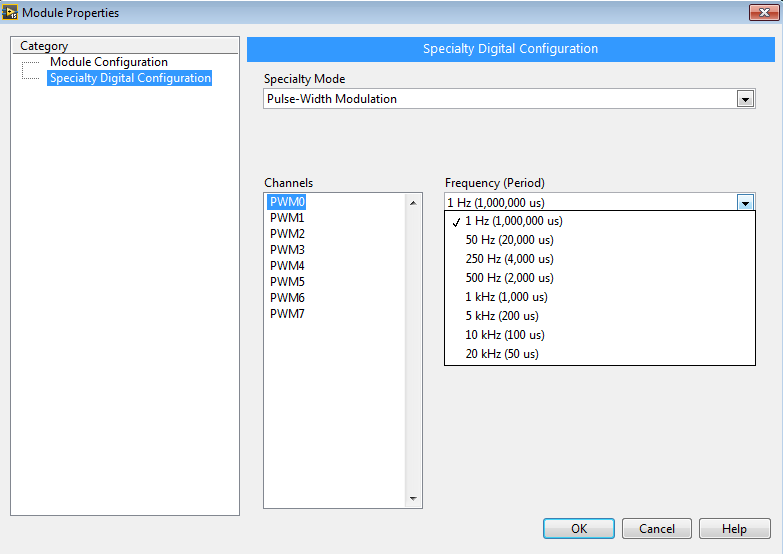

2. When the C Series Module Properties configuration window is visible select Specialty Digital Configuration from the Category window, then select Pulse-Width Modulation from the Speciality Mode window. Now you will be able to select the Frequency of the PWM signal for each channel, as shown in the image below.
Possible frequencies on supported modules are as follows:
C Series ModuleFrequencies
NI 9401*1 Hz, 50 Hz, 250 Hz, 500 Hz, 1 kHz, 5 kHz, 10 kHz, 20 kHz
NI 9402*1 Hz, 50 Hz, 250 Hz, 500 Hz, 1 kHz, 5 kHz, 10 kHz, 20 kHz
NI 94721 Hz, 50 Hz, 250 Hz, 500 Hz, 1 kHz, 5 kHz
NI 94741 Hz, 50 Hz, 250 Hz, 500 Hz, 1 kHz, 5 kHz, 10 kHz, 20 kHz
NI 94751 Hz, 50 Hz, 250 Hz, 500 Hz, 1 kHz, 5 kHz, 10 kHz, 20 kHz
