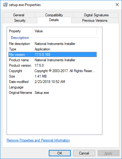

How can I determine the version of my NI Installer?
You can determine the version of your NI Installer from the properties of your installer's setup file:
  1. Find the executable file setup.exe in your distribution.
  2. Right-click setup.exe and select Properties.
  3. Select Details tab.
  4. The installer's version is displayed as File version.
