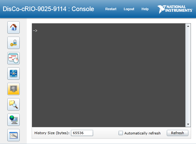

If you are using LabVIEW Real-Time 2010 or later, you can view the output from the Console Out using the NI Web-Based Configuration and Monitoring. Note that this feature is not available on targets running the Linux Real-Time operating system. If you are using an earlier version or are having trouble communicating over the network, skip ahead to follow the procedure for your Operating System below.
First ensure that NI Web-Based Configuration and Monitoring is installed on your controller by viewing it in MAX, then follow one of the methods provided in the LabVIEW Help to access the Configuration Page.  Navigate to the Console Task, which looks like this:

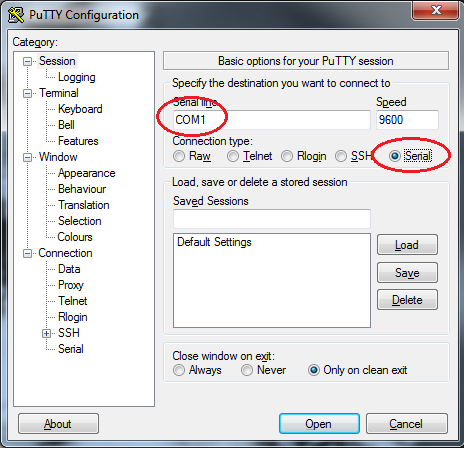

4. Select Serial and the COM port that the cable is attached to on the PC (typically COM1).
5. Set Speed (baud rate) to 9600.  See Additional Note #3 if using cRIO-903x or cRIO-906x.
6. Press Open.

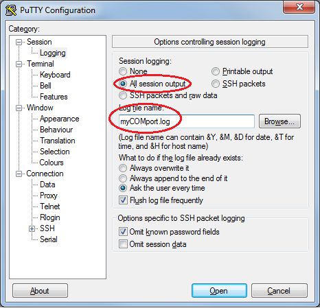

Note: In a troubleshooting situation, it might be useful to copy the information displayed in the terminal window and send that in to technical support. To log this information to disk on your host computer, follow this procedure:
1. Go to Session » Logging in the PuTTY configuration
2. Choose All session output
3. Give it a filename to save to

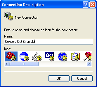

c. Create a new connection and enter a name.

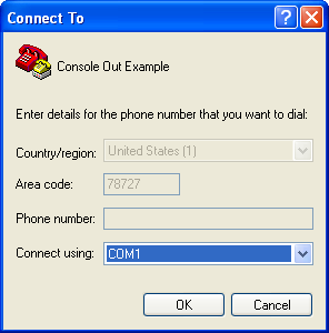

d. Select the COM port that the cable is attached to on the PC (typically COM1).

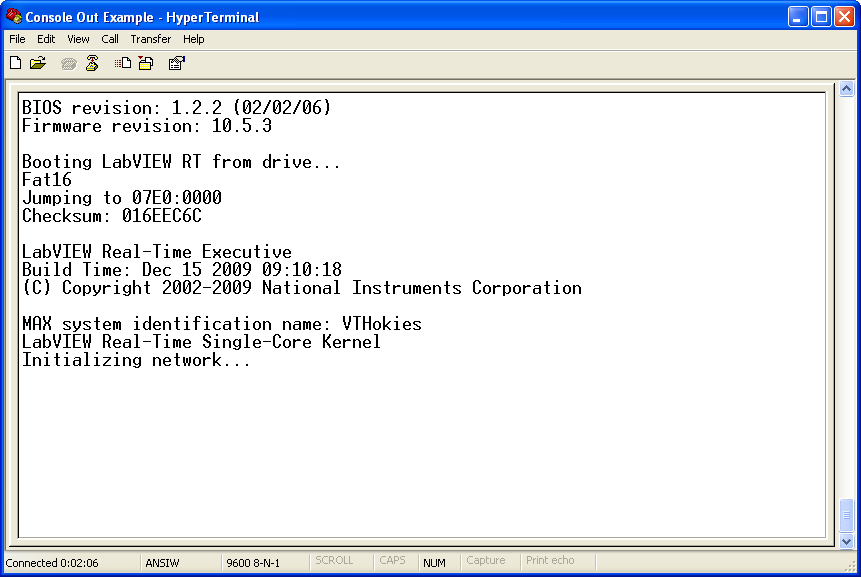

5. Power on the controller, and observe the output on the PC's terminal window.
6. Flip the Console Out switch back to OFF when done troubleshooting.

  • The value associated with "Bootrom version" on the Console output is the firmware version for cFP-22xx controllers.
