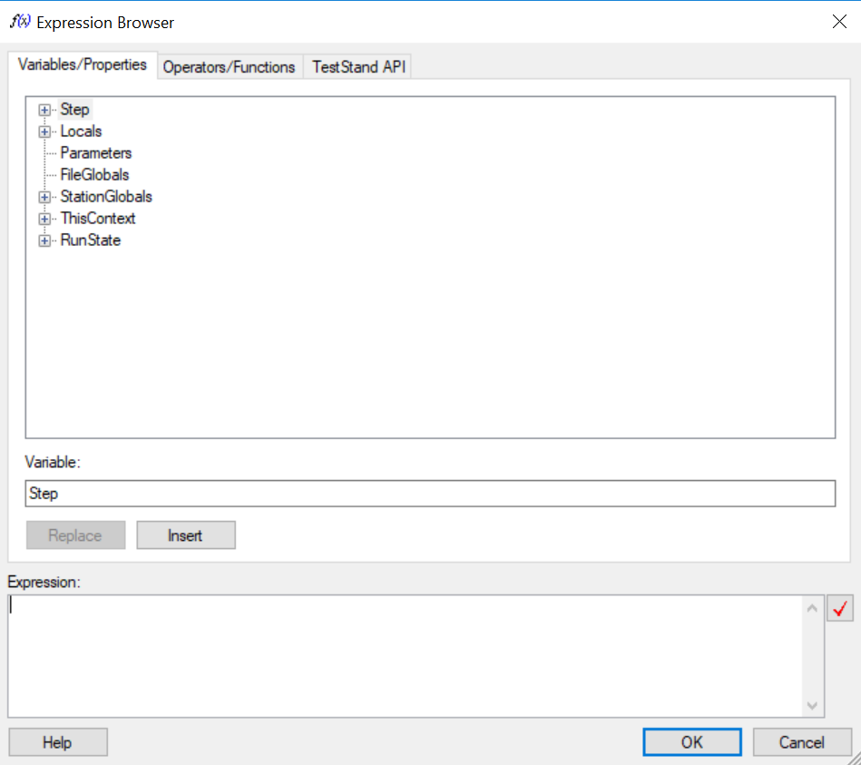

You can create and edit expressions by using the Expression Browser Dialog Box . The Expression Browser is available next to any expression textbox. Go through the following steps to open the Expression Browser Dialog Box and edit or create expressions.
1. Drag and drop a Statement step into your Main Sequence.2. Go the Expression tab of the step settings.
3. Expression Browser assists in constructing expressions. Click the Expression Browser button next to any expression textbox to launch the Expression Browser dialog box.
4. In the Expression Browser Dialog Box you can select variables and functions without having to know the exact syntax of the expression that you are wanting to execute.
