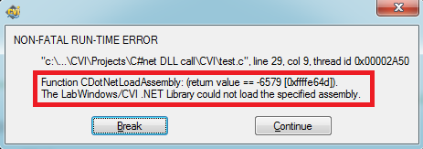

In particular, since the called DLL is not in the Global Assembly Cache, you need to register the .NET DLL with the CDotNetRegisterAssemblyPath function before calling. If not registered, the failed error as shown below will appear.
