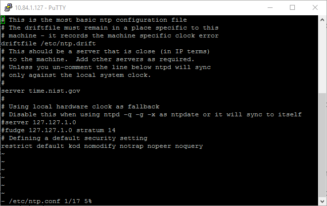

  9. Move the cursor with keyboard arrows. Add a line with server name in the format server <server URL or IP address>. You can add multiple servers in this file by placing each on their own line. If you need additional help configuring /etc/ntp.conf, there are many guides available on the internet.
  10. The file should now look like this:
