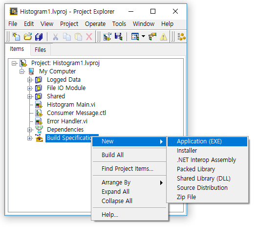

  1. Click Build Specifications » New » Application(EXE) in your project.
  2. Move the Main VI to the Startup VIs box in Source Files category. Select your Main VI and click the right arrow button.

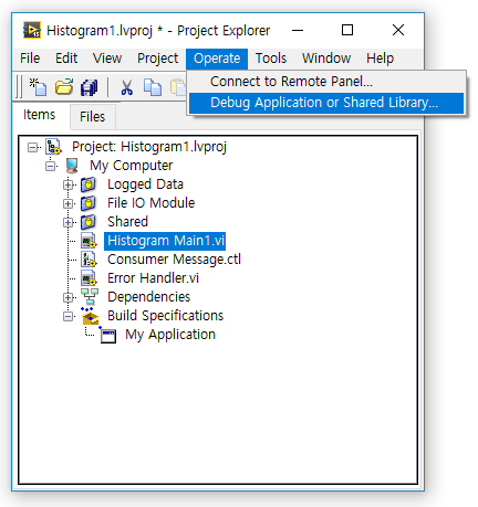

  6. Open your Project then Click Operate » Debug Application or Shared Library... (Keep the EXE open. If you close the application, LabVIEW cannot access the EXE.)

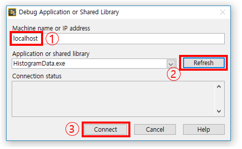

  7. Write localhost(If you debug in Local PC) in Machine name or IP address tab and click Refresh button. Select your EXE file in Application or Shared library tab. Last, click the Connect button. (If you debug in Target PC, refer to Remotely Debugging Executables in LabVIEW)

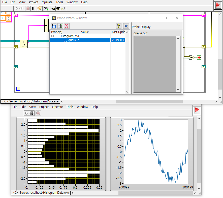

  8. After that, the front panel and block diagram are open. So you can debug the block diagram. You can use Highlight Execution, Probe etc.
