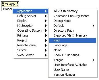

To programmatically determine the state of your application, use the Application Kind Property Node.
  1. Drop a Property Node from the Application Control palette on the block diagram.
  2. Select the Kind property as in the image below.
  1. The output of the property node will return an enum with the current operating environment. This enum can be used as the selector of a case structure to implement code accordingly.

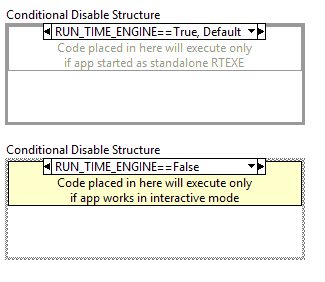

  • Real-Time Operating System
On the Real-Time Operating System the Application Kind Property Node will always return the value of Embedded LabVIEW, therefore it cannot be used to determine, whether it is a stand-alone RTEXE application.
You may use Conditional Disable Structure instead and check the value of the RUN_TIME_ENGINE symbol.
  • If RUN_TIME_ENGINE value equals True -  Application was started at boot as stand-alone RTEXE.
  • If RUN_TIME_ENGINE value equals False - Application was deployed from the development computer in the interactive mode.
