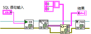

LabVIEW's own database advanced operations are an encapsulation of SQL query - the core is to use SQL language to operate the database. The figure below shows direct execution of the SQL statement. It avoids the disadvantages of advanced operation being unable to sort display and difficulty in executing a complex nested statement. It also enables convenient and quick use of various functions of SQL.
An example vi of direct execution of SQL in LabVIEW.
