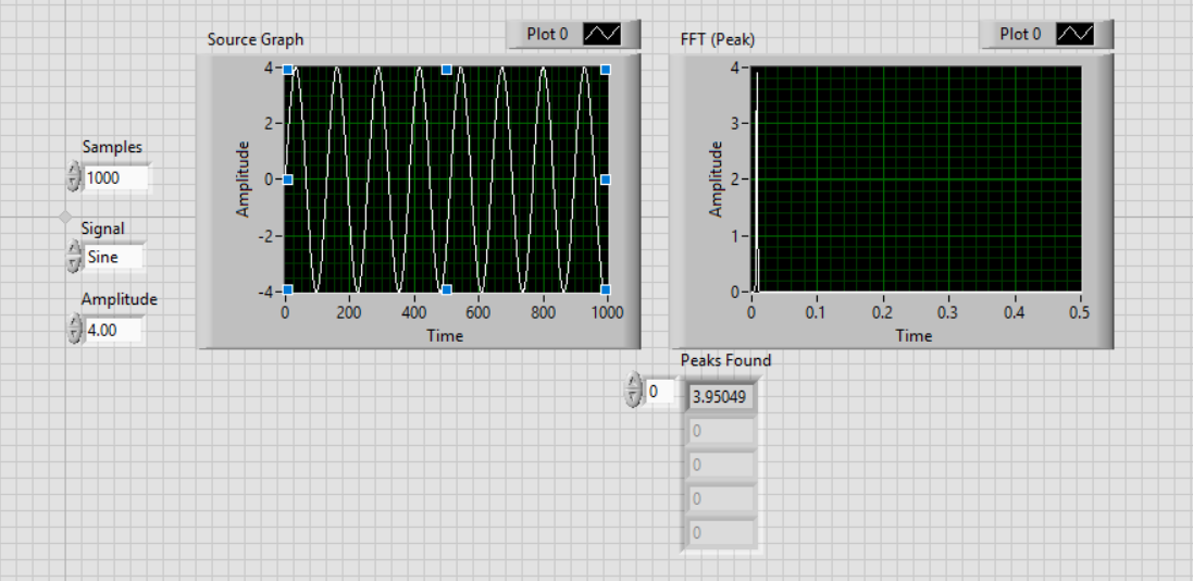

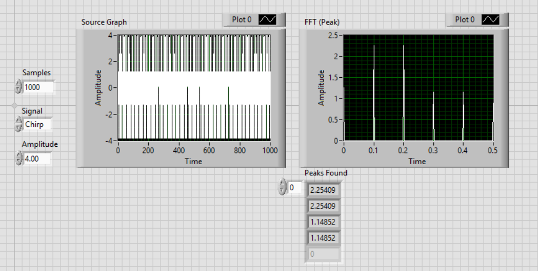

I'm using the Spectral Measurements Express VI to determine the Peak Magnitude of a signal without a fixed frequency, like a chirp signal. However, the reported peak magnitude is lower than the specified amplitude for my signal. This doesn't happen when I use a signal with a fixed frequency, like a sine wave. Why is this?
This lower output is actually expected, and is due to the construction of the non-fixed frequency signal and how FFTs determine peak magnitude. In order for the peak magnitude of a signal reported by an FFT to be equal to the maximum amplitude of the signal, there must be one cycle for each signal frequency component - signals with non-fixed frequencies vary with time, meaning that this cycle also varies, resulting in multiple peak magnitudes found that are lower than the maximum amplitude for the signal.
