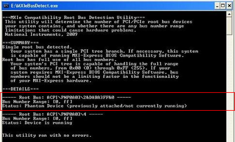

  1. Download and run the MXIeBusDetect.exe application attached at the bottom of this article.
Note: Only use MXIeBusDetect_32bit.exe on 32-bit Windows systems, and only use MXIeBusDetect_64bit.exe on 64-bit Windows systems.
  1. Look for root bus devices with Bus Number Range: [0, ff] and Status: Device is running
A full (non-limited) range of bus numbers will display as "[0, ff]". If the bus number range is not "[0, ff]", this indicates the motherboard has a limited number of buses to work with, and therefore may not be MXI-compatible.
An example of a system with limited range is shown below.
You might see phantom device status message, as shown below. These can be ignored.
  1. Press Enter to terminate the program.
