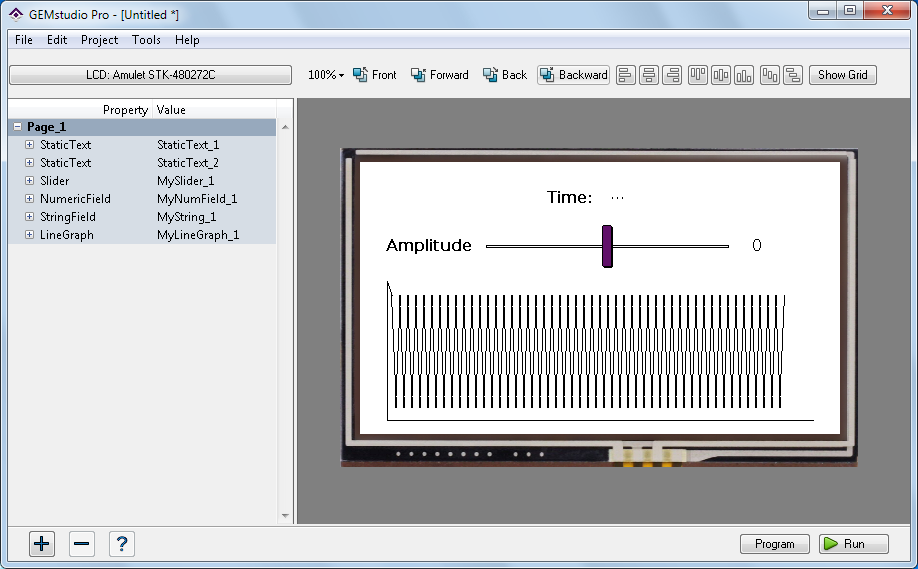

To finish the interface, display a graph of 100 random numbers generated by the host application. GEMstudio™ allows for arrays by utilizing consecutive internal RAM variables starting at a specific index. The host application will place 100 16-bit numbers in the internal RAM starting at index 0.
Add a LineGraph widget by clicking +»Widgets»LineGraph.
By default, the line graph does not display an axis. Right-click on the LineGraph widget in the properties pane and select Add/Remove Parameter.
Figure 15. Showing additional parameters for the line graph
Enable the showAxis parameter by checking the checkbox. Press Save.
Figure 16. Enabling the showAxis property for the line graph
Check the showAxis property and change xSamples to 100. This will allow you to display all 100 samples on the graph with the axis shown.
Figure 17. Modifying the properties of the line graph
Display the data from the internal RAM on the graph by creating a function call that reads 100 values starting at word variable 0. Click on the href property to open the Event Method List window.
Complete the function call using the tab key to display the options and show the following:
Amulet:internalRAM.words(x).array(y)
x is the starting index and y is the number of values. Change x to 0 and y to 100.
Figure 18. Completed function call for line graph
Press Done.
Use the mouse, alignment tools, and justification tools to arrange the user interface to look like Figure 19.
Figure 19. Completed user interface in GEMstudio™
Test the interface to make sure the slider still works as expected. The graph will not display data since there is no host application yet, but it should display the axis.
