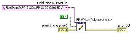

User LED on cFP (Legacy)
If you are targeting the cFP system, you can also use a FieldPoint Write VI to turn the User LEDs on or off. Right-click the block diagram and select Measurement I/O»FieldPoint»FP Write (Polymorphic) VI. Create a constant from the FieldPoint IO Point In terminal of the FP Write VI. Select Browse from the constant's drop-down box. In the Select Device section of the FieldPoint Device Selection window, select the cFP controller @0.
From the Select Item section of the FieldPoint Device Selection window, select the desired LED.
Wire a True or False constant to the Values input terminal of the FieldPoint Write VI if you would like to turn the LED On or Off.  The following code works only on the cFP.  It turns on User LED A.
