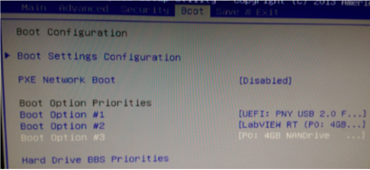

 - Press the Delete or the F10 key while the target is restarting to enter the BIOS.
 - In the BIOS go to the Boot tab and ensure that the UEFI USB drive is set as the first boot option.
- Note: It is important that you correctly configure this boot option or the reformat will not work properly.
- On the Save & Exit tab and proceed to Save Changes and Reset. When the target reboots it will begin the format process.

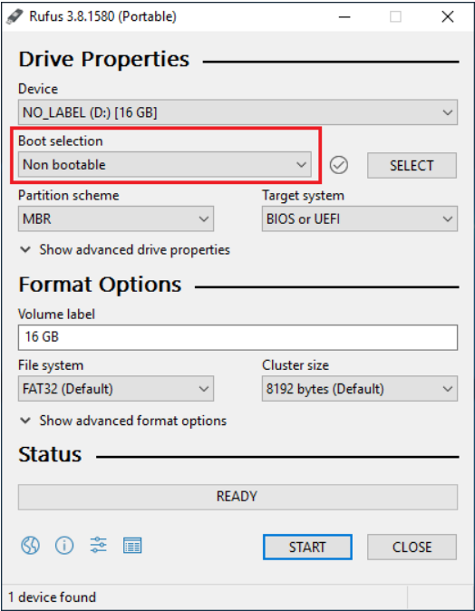

 - To recover the USB drive for future use, use [External] Rufus or similar software on the PC to format the USB drive to make it discoverable by Windows. Under Boot selection choose the Non-bootable option.
