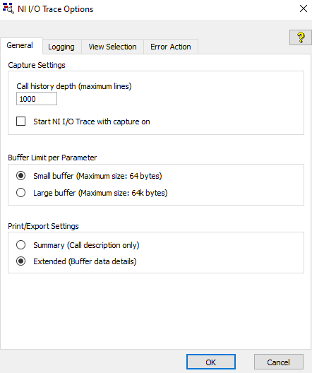

  2. From within NI I/O Trace, click Tools » Options.... Set the options on the General tab to match the picture below. An important property is the Call history depth. The capture should include the driver calls made to configure your device and the driver call where the error occurred. Make sure the number of maximum lines can allow this.

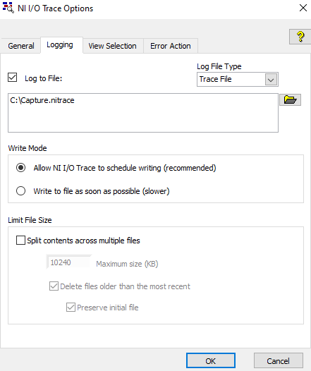

  1. On the Logging tab, select to Log to File.  The location of the file that you are logging the capture to is important; this resulting .nitrace file is the one that you will need to send to National Instruments.

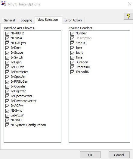

  1. On the View Selection tab, make sure that everything under Installed API Choices on the left side is checked. You may have different options than those listed below
