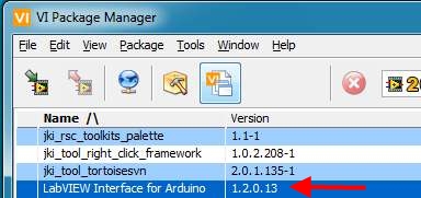

  1. Browse to LabVIEW Interface for Arduino in the list of packages.
  1. Click the Install & Upgrade Packages button.
  1. Click Continue.
You will see a screen indicating that LabVIEW will be restarted. When you click okay, LabVIEW will prompt you to save any open VIs as it is restarted.
  1. Click Finish.
The LabVIEW Interface for Arduino is now installed on your system. Once the toolkit is installed you can use VIPM to check for updates for it. When there is an update to the toolkit the icon in VIPM will change to look like the image below. Clicking the Upgrade Packages button will update the toolkit to the latest version.
