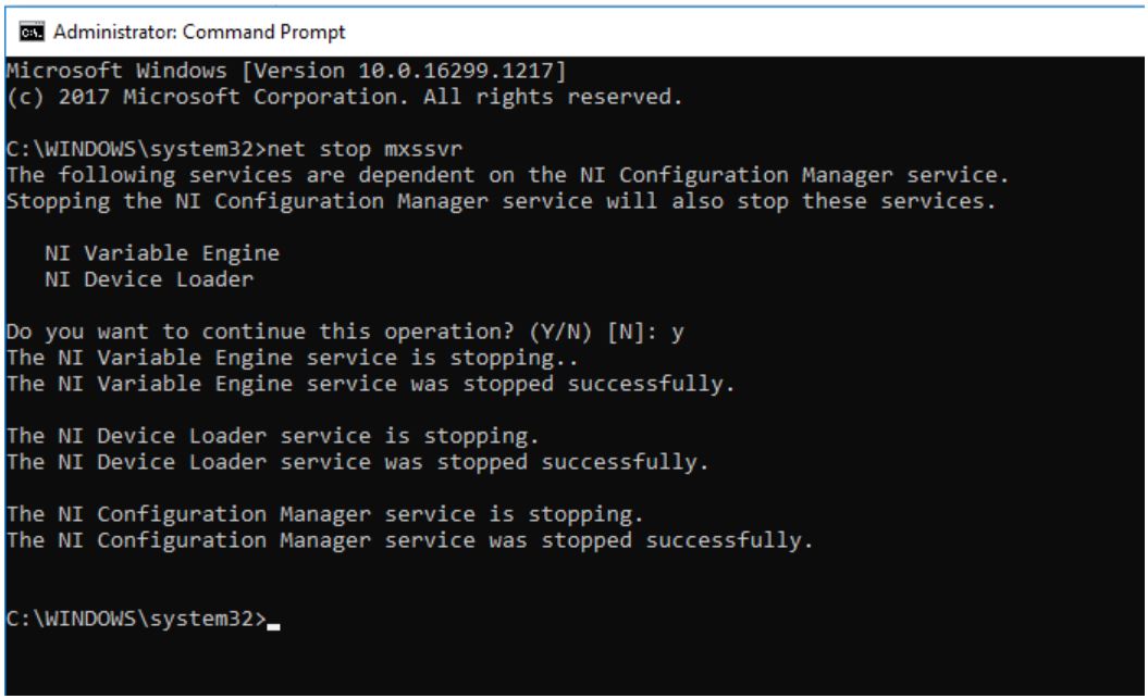

On Windows Vista, 7, or 10:
  • Select Programs » Accessories from the Windows Start menu.
  • Right click Command Prompt and select Run as administrator. If the command prompt is run without administrator privileges, you will receive System error 5 has occurred. Access is denied.
  • Type net stop mxssvr and press Enter to stop the MAX database service. If you are prompted to stop other services, stop them.
  • Type exit and press Enter to close the command prompt window.
  • If you can stop the service, skip directly to step #6.
