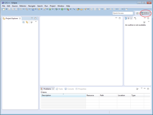

  3. In the Eclipse welcome screen, select the Workbench icon on the far right to open the workbench view.
  4. C/C++ Development Tools for NI Linux Real-Time, Eclipse Edition, highlight the active perspective on the perspectives bar, as shown in the following image. The first time you use C/C++ Development Tools for NI Linux Real-Time, Eclipse Edition, the workbench view opens in the C/C++ perspective.
    In the next section of this tutorial, you create a new project in the C/C++ perspective.
