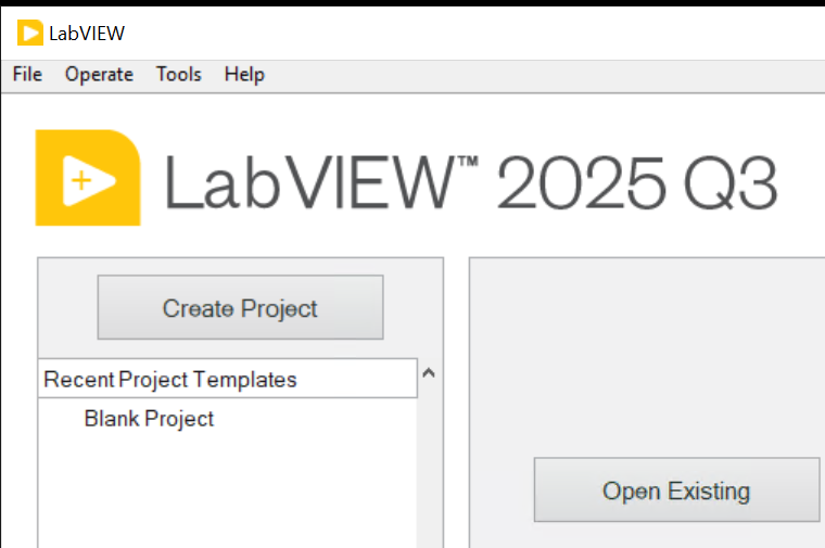

  1. Create a new project in LabVIEW by selecting Blank Project under Recent Project Templates
    Figure 1.
    Create a new LabVIEW project.

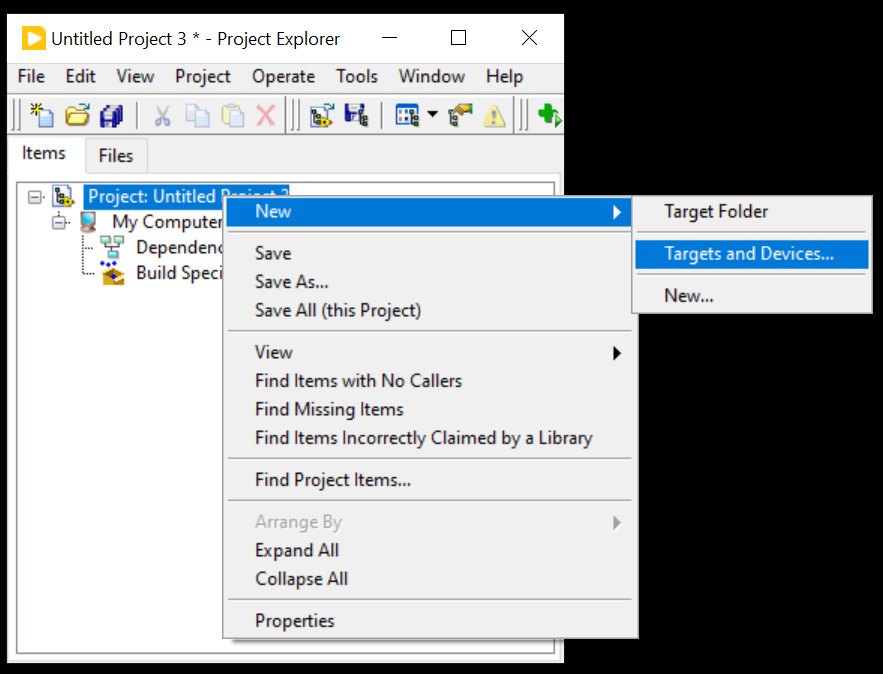

  1. Right-click the project root in the Project Explorer window and select New»Targets and Devices from the shortcut menu to display the Add Targets and Devices dialog box.
    Figure 2. Open target selection menu

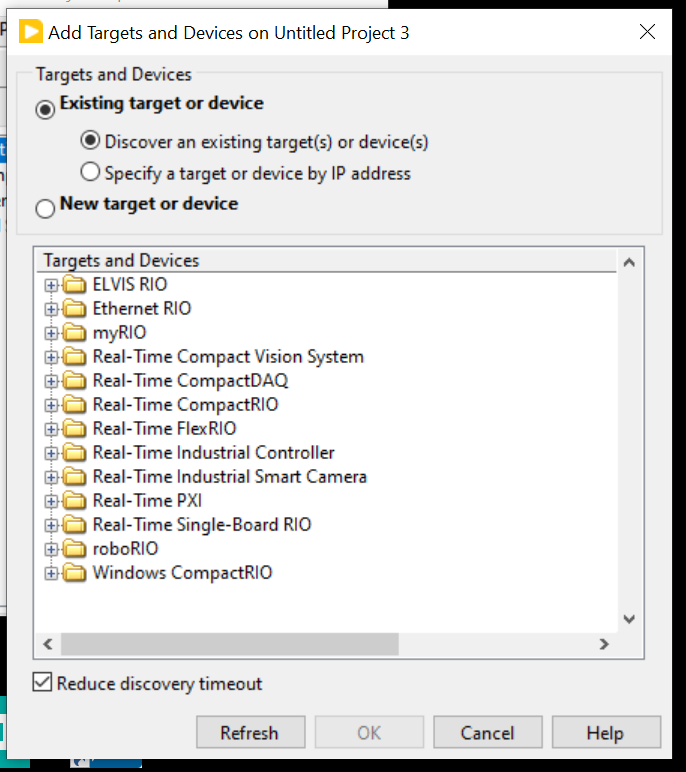

  2. Select the appropriate device from the Targets and Devices list,
    Figure 3. Target Selection Window
Note  If you cannot find the appropriate device, you may not have configured it for your network using Measurement & Automation Explorer (MAX). Launch MAX and refer to the Remote Systems help. Select Help»Help Topics»Remote Systems to open the Remote Systems help file.
