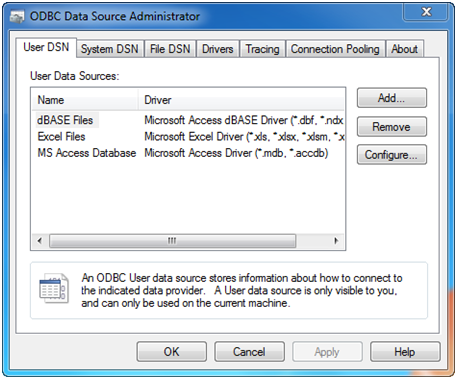

  4. Select the User DSN tab or the System DSN tab, depending on which type of data source you want to create. User DSNs are only visible to the user who created them on the current machine. System DSNs are available to all users on the current machine.
5. Click on the Add button. The following dialog box appears.

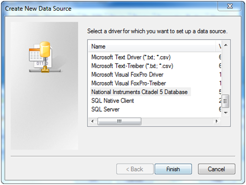

6. Select National Instruments Citadel 5 Database, then click Finish.

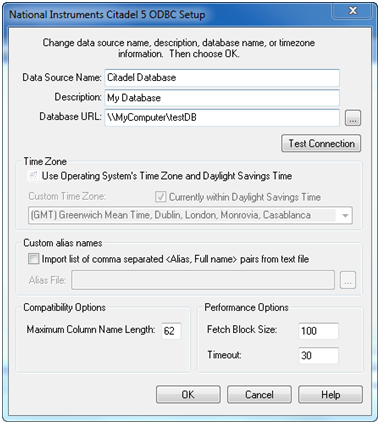

7. In the National Instruments Citadel 5 ODBC Setup dialog box, fill in the Data Source Name, Description, and Database Path fields.
a. The Data Source Name is the name that ODBC applications use to select your data source.
b. Description is a free-form text string you can enter to describe the data source.
c. Database Path should match the location of the Citadel database you intend to access. Use a fully qualified path to a remote computer if you are accessing the Citadel database on a remote computer, such as \\MyComputer\c:\dsc\database.
The Data Source Name must be different from any other ODBC data source name. The Description is arbitrary. The Database Path gives the location of the folder where the data for this source is stored.

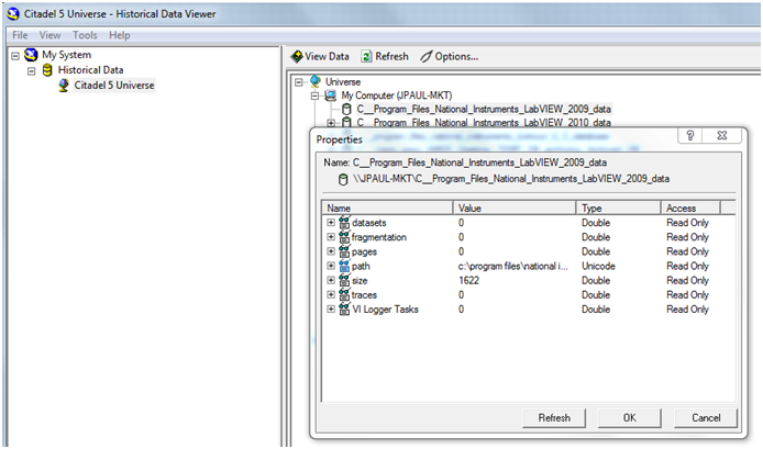

In the LabVIEW Datalogging & Supervisory Control (DSC) Module the default database path is the data folder under LabVIEW. Verify the database location at Tools » DSC Module » View Historical Data... When Measurement & Automation Explorer (MAX) opens, expand the left-hand historical data tree and highlight your Citadel database. Right-click on the database and select Properties… The resulting dialog box will display the current path to the database.
