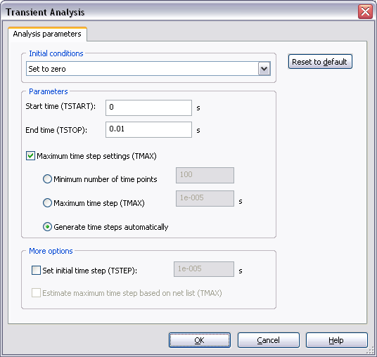

  1. Click the Edit transient analysis button.
  2. Configure the Transient Analysis window as shown in the following figure:
Figure 3. Transient Analysis window.
For more details on how to configure the Analysis Parameters tab refer to the Transient Analysis  tutorial.
