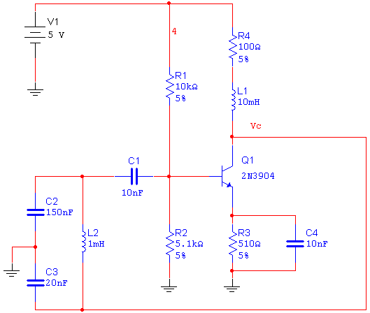

In this example, we calculate the DC value generated at the collector, VC, of the Colpitts oscillator circuit shown in Figure 1. You can get this file, colpitts_oscillator.ms11 from the Downloads section.
Figure 1. Colpitts oscillator circuit.

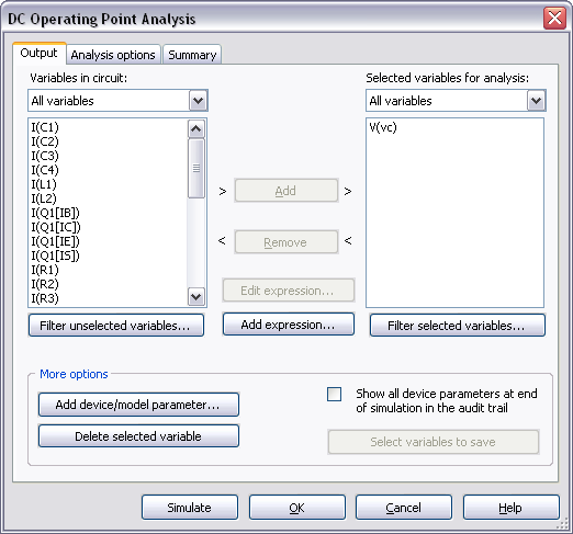

  1. Select the Variables in circuit list, select All variables from the drop-down list, and then highlight V(vc) from the list.
  1. Click the Add button to move the variable to the right side under Selected variables for analysis, as shown below.
Figure 2. Settings for the DC Operating Point Analysis.

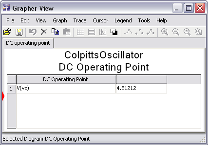

  1. Click Simulate to run the DC Operating Point Analysis. The Grapher View window opens and presents the result for V(vc):
Figure 3. Grapher View results for the DC Operating Point Analysis.

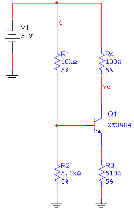

To verify this result you will analyze the Colpitts oscillator circuit shown in Figure 1. Keep in mind that when doing a DC Operating Point Analysis, inductors are shorted and capacitors are open. Figures 4a and 4b show the reduced circuit.
(a)
(b)
Figure 4. Reduced circuit to calculate the DC operating point.
Use the following expressions to calculate the collector voltage, VC:
Divider current:
Base voltage:
Emitter voltage:
Emitter current:
Collector current:
Collector voltage:
Note that this calculation (V= 4.81 V) matches the result obtained by the DC Operating Point Analysis in Multisim.
