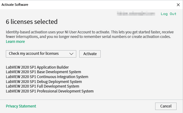

  1. After launching the NI License Manager you'll click the Activate Software Tab.
    • Select Check my account for licenses from the drop-down menu and click the Activate button.
    If the above method fails or if your serial number is still not shown as registered in your NI User Account, you can proceed using the Serial Number Activation method.

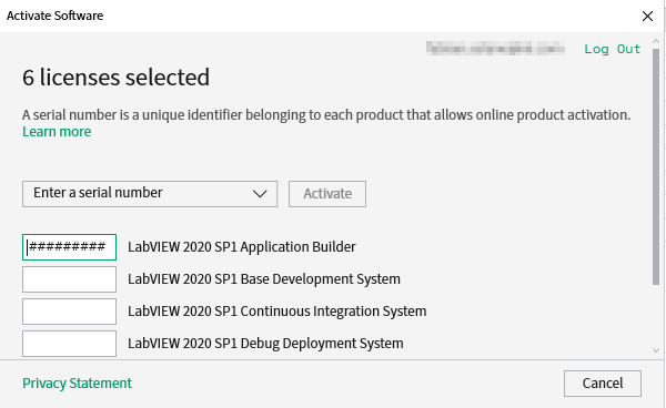

    1. Select the Enter a serial number option from the drop-down menu.
    2. Enter your serial number(s) next to each software product that you want to activate.
    3. Click the Activate button.

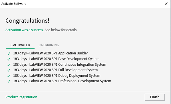

    If the activation was successful, you should receive a message similar to the window below.
    If you receive an activation error, please refer to Invalid Serial Number Error in NI License Manager.
