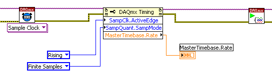

DAQmx Timing Property Node
The DAQmx Timing Property Node gives the user access to dozens of attributes that are not available from the DAQmx Timing VI.
C Function: DAQmx<Get/Set/Reset>SampClkActiveEdge
                 DAQmx<Get/Set/Reset>SampQuantSampMode
                 DAQmx<Get/Set/Reset>MasterTimebaseRate
From this property node, you can change the Active Edge of the clock, configure Change Detection on a digital line, or query the sample clock rate. In general, this property node provides you with dozens of more advanced timing properties.
