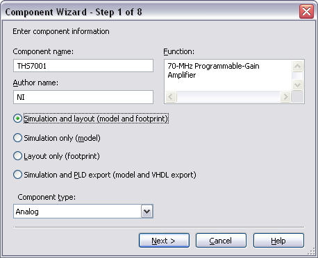

Step 1:  Enter Initial Component Information
- Select Tools»Component Wizard from the Multisim main menu. The Component Wizard window opens.
- Configure this window as shown in the following figure.
Figure 1. THS7001 component information.
- Click Next to continue.

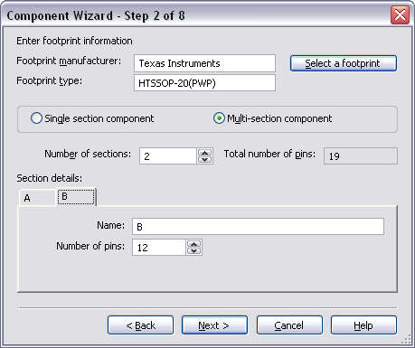

In this step you will enter the footprint information.  According to the datasheet, this component  uses the HTSSOP-20 PowerPAD (PWP) footprint. You will select this footprint from the Multisim Master Database.
- Click on the Select a footprint button. The Select a Footprint window opens.
- Select the Master Database in the Database name listbox.

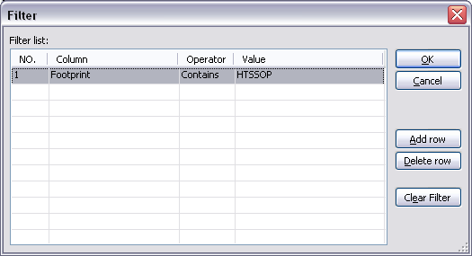

- Click Filter. This helps you do a quick search within the thousands of footprints.
- Click the Add row button.
- Configure the Filter window as shown in Figure 2.
Figure 2. Filtering footprints.
- Click OK. The Select a Footprint window displays a list of footprints as shown in the following figure.
Figure 3. Selecting the HTSSOP-20(PWP) footprint.
- Highlight the footprint HTSSOP-20(PWP) and click Select.
Note: To learn how to create a custom footprint in NI Ultiboard take a look at the Creating a Custom Component in NI Ultiboard tutorial.
Now you need to define the number of sections and pins in the component. In this case there are two sections: A is the pre-amplifier section, it contains 7 pins; and B is the programmable gain amplifier section, it contains 12 pins.
- Configure the multi-section parameters as shown in Figures 4a and 4b.
(a)
(b)
Figure 4. Multi-section parameters.
Note: When creating multi-section components, the number of pins must match the number of pins that will be used for that section’s symbol not the number of pins of the footprint. In the case of the THS7001, you will add the ground pin and the power-saving shut-down pin to the symbols for both sections.

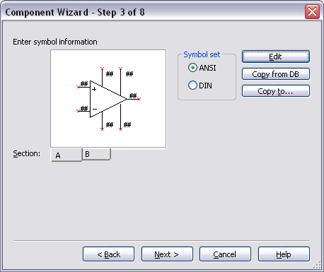

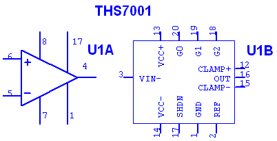

After defining the sections and selecting the footprint, assign the symbol information for each section. The Component Wizard generates a default symbol, however, you can edit this symbol in the Symbol Editor or copy an existing one from the Master Database. To save time when creating custom parts, it is recommended that you copy existing symbols from the Multisim database wherever possible. You can also load symbol files into the Symbol Editor.
- Click the Edit button. The Symbol Editor opens.
- Select File»Open and select the file pre_amp.sym. The Symbol Editor loads the symbol for the pre-amplifier as show in the following figure:
Figure 5. Symbol Editor.
- Select File»Exit to close the Symbol Editor, if asked to save changes choose Yes. The pre-amplifier symbol will now be displayed in the preview box (Figure 6).
 If you plan to share this component with colleagues around the world, it is a good idea to create both ANSI and DIN symbols for the device. In this case, simply click on the Copy to button, then select Section A (DIN).
Figure 6. Pre-amplifier symbol.

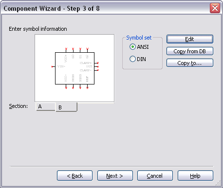

Assign a symbol for the programmable gain amplifier section:
- Select B in the Section field.
- Click on Edit to open the Symbol Editor.
- Open the file pg_amp.sym.
- Select File»Exit to close the Symbol Editor, if asked to save changes choose Yes. The pre-amplifier symbol will now be displayed in the preview box as shown below:
Figure 7. Programmable gain amplifier symbol.

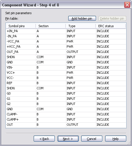

Step 4: Set Pin Parameters
In this step you can select the pin model type (input, output, and so on) for each pin in the symbol. You can also configure whether to include or exclude that pin from Electrical Rules Check (ERC). If needed, you can add hidden pins to components in this step. Hidden pins are pins that do not appear on the symbol but may be used by the model and/or the footprint.
- Configure the Section and Type columns as shown in the following figure:
Figure 8. Pin parameters.

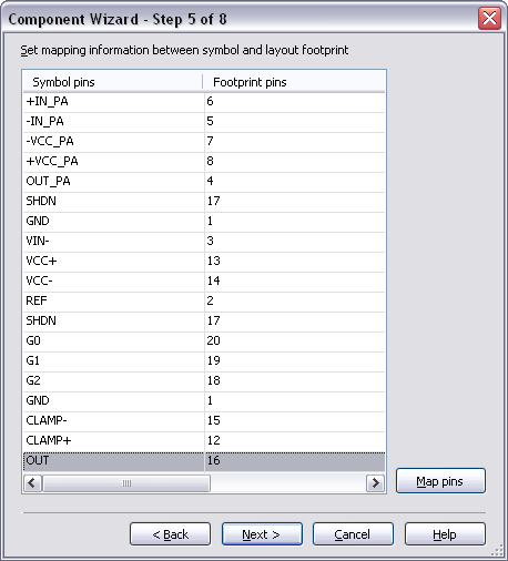

Step 5: Set Mapping Information between Symbol and Layout Footprint
Map visible symbol pins and hidden pins to the PCB footprint.  Ensure that the mapping is accurate by comparing it to the datasheet information.
Note: Simulation-only parts do not require this step.
- Click the corresponding Footprint pins cell for each row and assign a pin number. The configured window will look like Figure 9. Note that pins 1 and 17 shared pins.
Figure 9. Mapping information between symbol and layout.

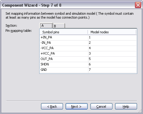

Step 7: Map Symbol Pins to the Model Nodes

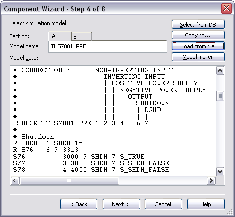

You must map the symbol pins to the SPICE model nodes in order for Multisim to correctly simulate the component. For all subcircuit or macro models, the model nodes are typically documented in the header text of the SPICE model. There is also a line that declares that the model is a subcircuit model and lists the model name followed by the model nodes that will connect to external circuitry.
For the THS7001, the model nodes of the pre-amplifier and the programmable gain amplifier are listed in the files ths7001_pga.cir and ths7001_preamp.cir. You can open these files in a text editor.

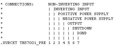

Let us examine the header and subcircuit (SUBCKT) lines for the pre-amplifier:
The .SUBCKT line declares that the model is a subcircuit model, lists the name of the model, and displays the external nodes. The comment lines (SHUTDOWN, OUTPUT, and so on) describe the order and operation of the model nodes.
- Complete the pin mapping table for the pre-amplifier (section A) as shown in Figure 11. You must select the Model nodes based on the order in which they appear in the SUBCKT line.
Figure 11. Section A pin mapping table.

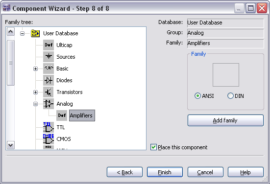

9. Step 8: Save Component into the Database
Once all the previous steps are complete, save the component to the User or Corporate Database.
- Expand the User Database.
- Select the Analog group.
- Click Add Family and type Amplifiers as the new family name.
- Click OK.
- Highlight the new Amplifiers family as shown below:
Figure 13. Saving the component to the database.
- Click Finish and place your custom component (Sections A and B) on the Multisim workspace area.
Figure 14. THS7001 Sections A and B.

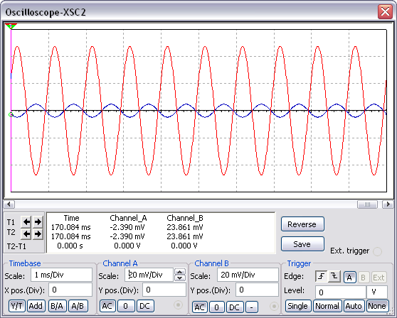

10. Testing the New Component in Multisim
After creating and saving the custom component, it is available for use in Multisim. To test this component, use the test_circuit.ms11 file located in the Downloads section. Replace U2A with section A of your new component and replace U2B with section B. To replace a component, double-click on the component and then select Replace. Then navigate to the database and location that you saved your component and select it.
Figure 15 illustrates the expected response of the test circuit.
 Figure 15. Time domain response of the PGA with Gain set to 111.
