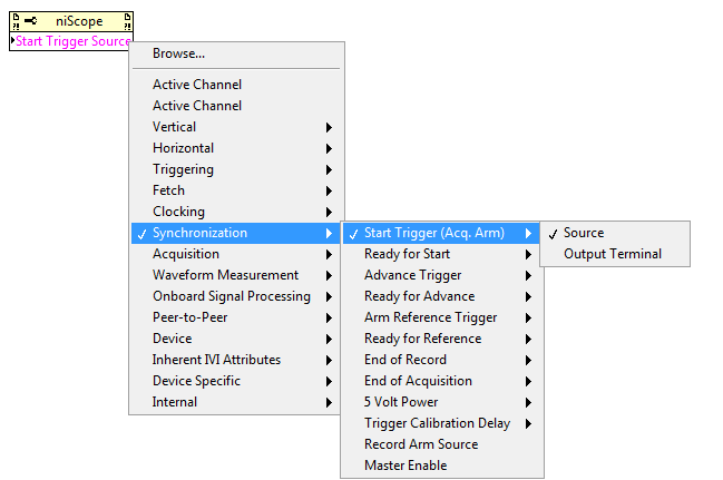

How to use the "Start trigger" function with NI-SCOPE just like in DAQmx? I tried to use "niScope Configure Trigger (poly)" but it did not work as I expected.
I want to do a continuous measurement with a NI-SCOPE card that is started by a start trigger. How do I implement this?
You are not able to specify a "Start Trigger" directly with the NI-SCOPE API. If you want to do so, you'll need to use NI-SCOPE property node instead of API. The image below show the property node that allows you to specify the start trigger source.

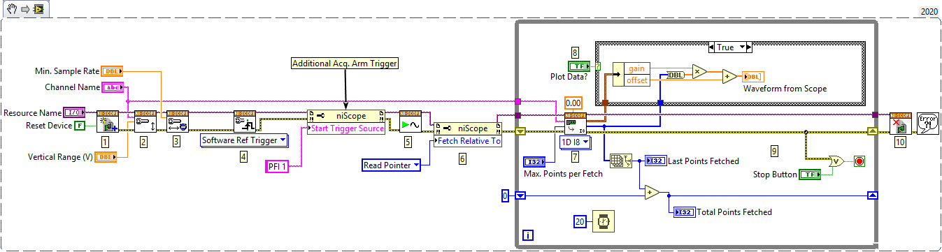

LabVIEW provides some NI-SCOPE examples, which you can use for quick development. Below is a modified version of the example "niSxope EX Fetch Forever.vi". It uses an external signal on PFI1 as a start trigger.
Note: This image is a LabVIEW snippet, which includesLabVIEW code that you can reuse in your project. To use a snippet, right-click the image, save it to your computer, and drag the file onto your LabVIEW diagram.
