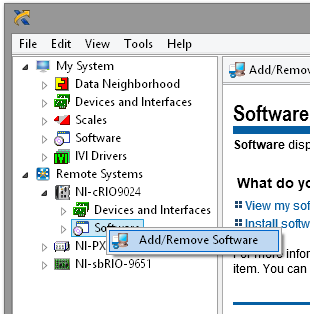

    9. Right-click on Software and select Add/Remove Software - the Software folder will not be visible in the configuration tree in NI MAX if the controller does not have a valid IP address.

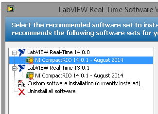

    1. Some controllers install using Recommended Software Set's (RSS)'s. If your controller does not have an RSS option, proceed to Step 11.
    RSS's simplify the install process by automatically selecting the required base software components. Select the RSS for the version of LabVIEW Real-Time you wish to install.
    The RSS selection will select to install the base requirements for that Real-Time and driver version. Next, another window will open allowing the selection of other optional install components.

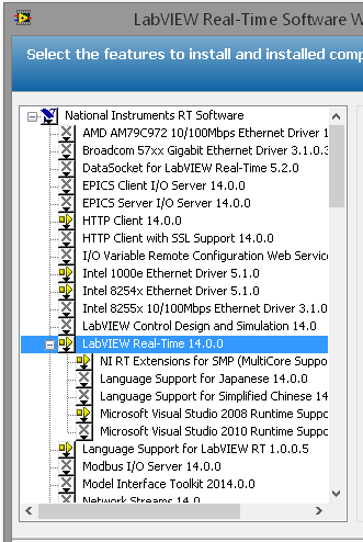

    1. If the controller does not have a RSS option then the specific software must be selected manually.
    1. Select Next. Review the software to be installed.
    2. Select Next to begin the installation process.
