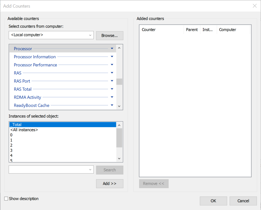

Performance Monitor displays information by graphing the values of counters. Counters represent various aspects of memory usage and system performance. You can configure the set of counters displayed on the Performance Monitor graph.
  1. Select any existing counters in the table at the bottom of the Performance Monitor window.
  2. Press the Delete key on the keyboard to remove these counters from the graph display.
  3. Right-click on the graph area. Click Add Counters…
The Add Counters dialog box appears. There is a scrollable list box with all the counters available to you, categorized by group.
  1. Locate the group you are interested in, expand it, and select a counter.
    For memory growth issues, it is often useful to enable the Private Bytes, Handle Count, Thread Count, #Bytes in all Heaps, and Gen2 Heap size counters. All these metrics are a snapshot of the resources currently used by the application.
    The following table explains the meaning of each counter.
    Note:
    For any other counters not included in the table, enable Show Description to view the description of the counter.
Group   Counter    Description
ProcessPrivate BytesThe amount of private memory in use by the process. A process’ virtual memory space consists of private memory, which can only be accessed by the process, and shared memory, which can be accessed by other processes.
ProcessHandle CountThe number of object handles in the process’s object table. Maintaining references to instrument driver sessions, loading LabVIEW VIs, and many other operations can cause the number of handles to increase.
ProcessThread CountThe number of threads running in the process.
.NET CLR memory # Bytes in all HeapsThe total amount of memory being used by the process to store .NET objects.
.NET CLR MemoryGen 2 heap sizeThe amount of memory being used by the process to store .NET objects on the Gen 2 heap. The Gen 2 heap is an area of .NET memory where objects which have been in memory for a long period of time are stored. This value may indicate that .NET objects are not being released when they are no longer needed.
  1. Select the process of interest in the Instances of selected object list.
For TestStand systems, this is typically SeqEdit or the name of your user interface executable, depending on whether you are executing your test system in the TestStand Sequence Editor or a user interface.
For LabVIEW select LabVIEW, and for LabVIEW-based applications, select the name of the executable.
  1. Click the Add button to add the counter to the Added counters list.
  2. Repeat steps 6-8 until you have all your desired counters in the Added counters list.
  1. Click OK on the Add Counters dialog. The Performance Monitor graph begins to update with the values of the newly added counters.

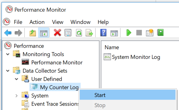

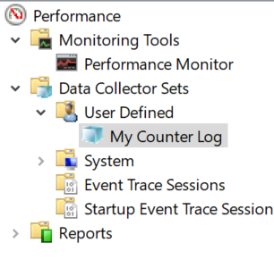

Log Memory Data to File
  1. Right-click on Performance Monitor from the configuration tree. Select New»Data Collector Set.
  1. Enter a name for your data set. Press Next.
  1. Choose the location where you want to save your log file. Click Next.
  2. Select Save and Close. Click Finish.
The new Data Collector Set appears in the Configuration tree under Data Collector Sets >> User Defined.
When you want to start logging the performance data, right-click on your Data Collector Set and select Start. To stop logging, right-click and select Stop.
