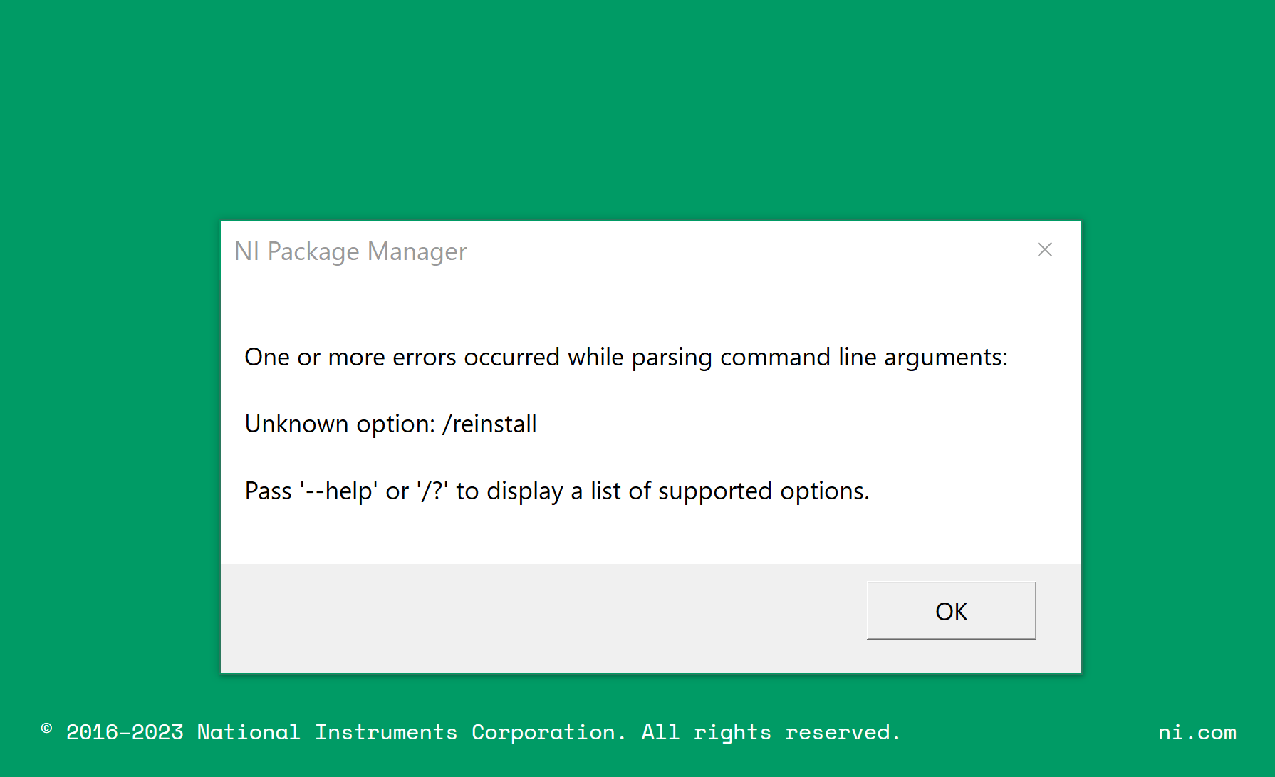

Note: the force-reinstall option is only available for software that was installed through individual product installers or suite installers without NI Package Manager. If your software was installed through NI Package Manager; you would get errors such as " /reinstall command is not found " in the Command Prompt or PowerShell or could get a Window stating that the /reinstall command is an Unknown option as shown below:
For software that was installed through NI Package Manager, the repair/reinstall process can be performed following the steps on this KB: Repair Software in NI Package Manager (NIPM). For further details on NI Package Manager options please visit Installing, Updating, Repairing, and Removing NI Software.

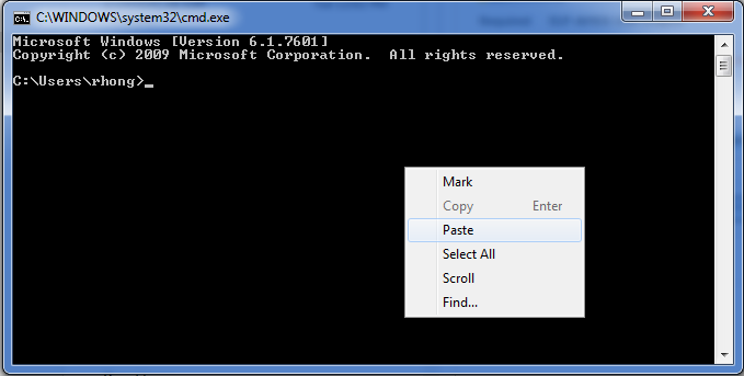

Note: Since you can't use Ctrl+V to paste in the command prompt, you can right-click anywhere in the window and select Paste to insert a long directory. Although you can use Ctrl+V to paste the directory into Windows PowerShell.

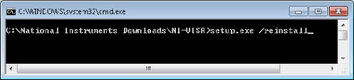

- If you have entered a valid directory, you should see the directory change in the command prompt. In this example specifically, the user wishes to force reinstall NI-VISA driver whose installation files are located in C:\National Instruments Downloads\NI-VISA.
- Run the installer by typing setup.exe /reinstall or .\setup.exe /reinstall (PowerShell) and pressing <Enter>. The images below show how your command should look before you press <Enter>. This will reinstall all of the files instead of only ones that appear to be damaged or missing.

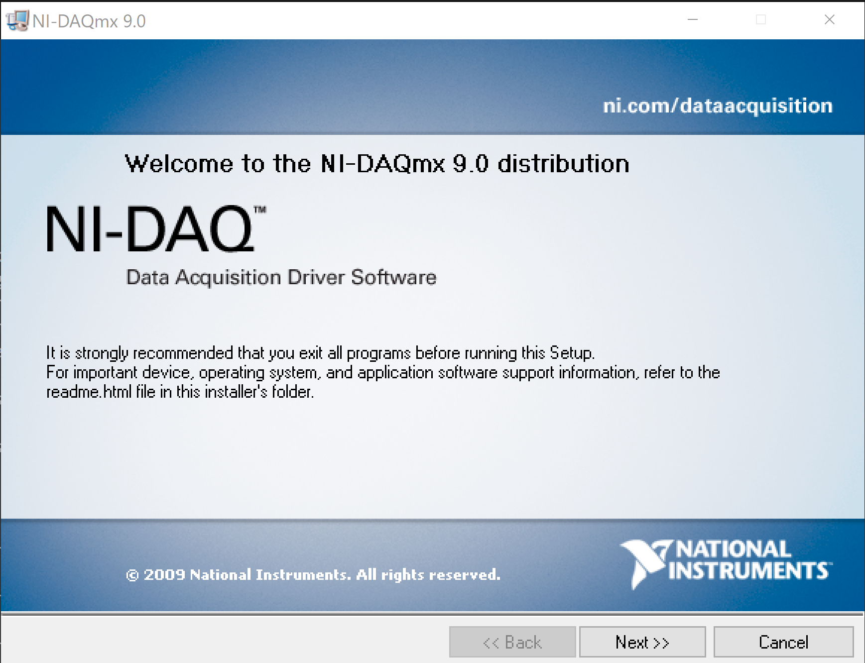

Once the above command is executed, the original installer will appear to proceed with the operation as the example below:
