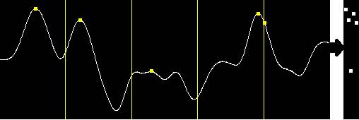

Detectors – When you want to determine what values should represent the measured spectrum on a display with a fixed number of points, you must choose some algorithm. In traditional swept spectrum analyzers, detectors serve this purpose. The detector reduces intervals of continuously swept data down to discrete display points across both time and frequency. In terms of the frequency, the detector reduces the data contained in an interval defined by [Span]/[Number of display points] to a single display point. In terms of time, the detector reduces the data contained in an interval defined by [Sweep Time]/[Number of display points] to a single display point. The value chosen to represent the interval is determined by the type of detector chosen, for example, the average of the data in the interval, the positive peak of the data in the interval, and so on.
Note: The number of display points is user-configurable on many traditional spectrum analyzers but this doesn’t change the general premise behind detectors. The application of detectors is still a mapping process – the user can simply choose the number of points in the resulting map.
Figure 3 illustrates the application of a peak detector. The image on the left represents the continuous signal and the image on the right represents the points on the display. In this case, the maximum value in each of the 5 intervals on the left is chosen to represent the entire interval. Each of these values is then mapped as a single point on the display to the right.
![](/servlet/rtaImage?eid=ka03q000000ZLQD&feoid=00N3q00000HUsuI&refid=0EM3q000001JX4B)
Figure 3. A continuous signal representation on the display when using a maximum peak detector
