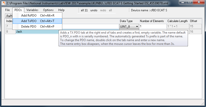

Creating PDO(s)
The labels “RX” and “TX” represent Receive and Transmit and are from the perspective of the network. For example, a module TXPDO is a PDO that the cRIO ECAT module receives from the EtherCAT network. Determining if you need both RXPDOs and TXPDOs will require knowledge of your objectives for this EtherCAT device as a part of the larger network – what will the master send to it? What will it send to the master? These are core questions to determining the type and number of PDOs to create.
To create a PDO, go to PDOs » Add RxPDO or Add TxPDO based on which you would like to create.
Figure 2. Creating a TxPDO in the PDO-Configurator

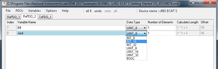

Once you create a PDO file, you’ll need to populate it with variables. For an RXPDO, these need to match the data being sent to this EtherCAT device (both in index and datatype). You can add variables by going to Variables » Add Var. Then, set the Variable Name and Data Type. If you change Number of Elements to something else, then one the configurator will create an array datatype. The Index of each variable will be important later when you wish to access PDO data in your LabVIEW application.
Note: The NI EtherCAT Master software does not support array data types.
Figure 3. Setting the data type of a RxPDO variable in the PDO-Configurator
