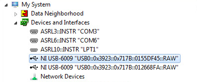

My NI USB devices are showing up with RAW in their name in Measurement & Automation Explorer (MAX) on my Windows machine. Additionally, I cannot communicate with them using Test-Panels or reset the device. Why is this happening?

1. Expand the Software category in NI-MAX to view which drivers you have installed. If you have both DAQmx and DAQmx Base installed, you can see which driver the device is associated with:
  • Select the device.
  • Navigate to the Attributes tab found on the bottom of your screen
  • View the Driver Name as shown below.
2. If you are developing an application for a Mac or Linux machine then DAQmx Base is the correct driver. If you are developing for a Windows machine then you should use the DAQmx driver.

Devices will show up with the RAW label in NI-MAX when the DAQ device is configured to use the DAQmx Base driver on a Windows machine. The DAQmx Base driver is most commonly used to program DAQ devices for a Mac or Linux computer. If you are developing for an application that will be run on a Mac or Linux system, you are set up correctly. However, if you are developing an application for Windows, the recommended driver is DAQmx.
