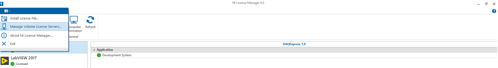

For License Manager 4.0 or later:
1. Open the NI License Manager located in All programs>>National Instruments>>NI License Manager
2. Click on the Options Menu, on the top-left corner, to display the Preferences options.
3. Select "Manage Volume License Servers..." as shown:

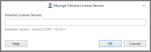

4. In the Manage Volume License Servers window, introduce the Volume License Server name.
5. Click OK to close the Volume License Servers window.

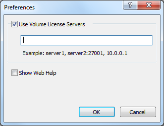

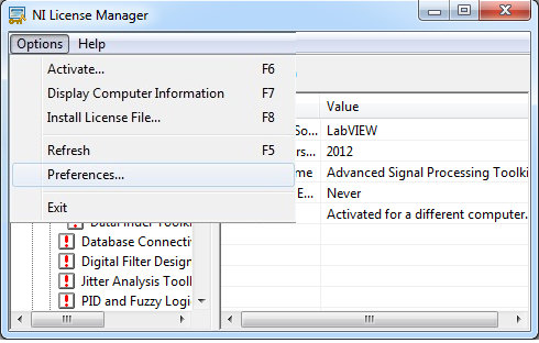

For License Manager 3.7 or earlier:
1. Open the NI License Manager located in All programs>>National Instruments>>NI License Manager.
2. On the top menu, go to Options>>Preferences
3.  In the Preferences window, introduce the Volume License Server name.
4.  Click OK to close the Volume License Servers window.
Note: If you changed the Main Licensing Port in VLM, the server name and port number, separated by a colon, must be entered as the Volume License Server name.
For example: "ServerName:27001".
If you've successfully connected to the license server and still don't see any network licenses, you may need to reach out to your licensing administrator to make sure you have been assigned a license on the server.
