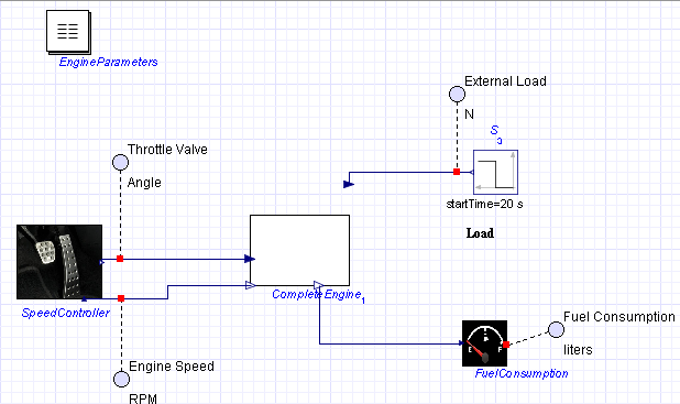

  • Add a picture to represent the CompleteEngine in the Main diagram.
    1.  Go to the Icon Tool
    2. Select the outline of the subsystem
    3. Select the drawing fill tool
    4. Select Browse
    5. Select the picture you would like to insert into the diagram and select Open
  • Go back to the diagram by selecting the diagram tool.
  • Navigate to the Main subsystem and add a probe for the BrakePowerOutput. Name it BrakePower with units kw. You can do this by right clicking the output of BrakePower and selecting attach probe.

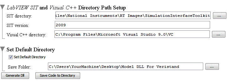

  • Select the default directory that SIT was installed to on your computer along with the SIT version. As well select the default Directory that you want to save the dll to under Set Default Directory
  • Select Generate DLL, Maple will then generate the C code for the model and store it into the defined folder.
