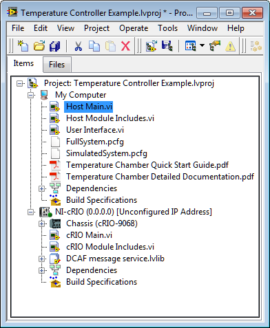

We believe this to be the best way to jump-start your knowledge and abilities in DCAF. It walks through an example application (RT Temperature Controller) that will expose you to the workflow and main toolchain of DCAF.  The hands-on is estimated to take between 3 and 6 hours to complete.  It can be completed with or without a CompactRIO controller, although the exercise is more valuable if you try it with one.
Figure 2. RT Temperature Controller project
