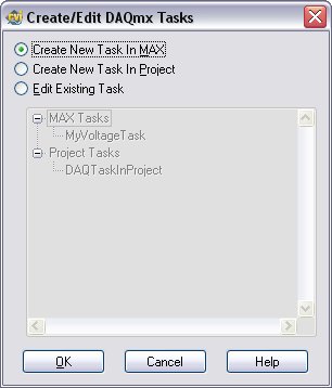

To launch the DAQ Assistant from LabWindows/CVI, select Tools»Create/Edit DAQmx Tasks. The dialog box shown in Figure 1 appears.
Figure 1
You have two options when creating tasks for use in a LabWindows/CVI project.
  • MAX-based tasks are global to the machine on which they are created and can be used by other programs on the same machine. You can view, edit, and test this type of task directly from within MAX. You can use MAX-based tasks in multiple projects, even those that are not in created in LabWindows/CVI.
  • Project-based tasks are stored in a project. Tasks stored in the project are local to that project. Project-based tasks can be more convenient if you need to share a task definition among multiple developers or store the task definition in a source code control system.
Create a MAX-Based Task
  1. Select Create New Task in MAX from the Create/Edit DAQmx Tasks dialog box.
  2. Click OK to launch the DAQ Assistant.
  3. In the next dialog box, select the measurement type for your task and click Next.
  4. Select the virtual channels and click Next.
  5. Enter a name for the task and click Finish. The DAQ Assistant creates the task.
