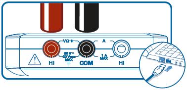

First, connect the red DMM probe to the HI V input and the black DMM probe to the COM input on your myDAQ Student Data Acquisition Device. If you have not already done so, use the USB cable to connect your Student Data Acquisition Device to your computer.
![](/servlet/rtaImage?eid=ka03q000000lNgB&feoid=00N3q00000HUsuI&refid=0EM3q000001JSCh)
DO NOT plug DMM probes into circuits with hazardous voltage, such as wall outlets. READ the NI myDAQ User Guide and Specifications prior to myDAQ Student Data Acquisition Device use.
