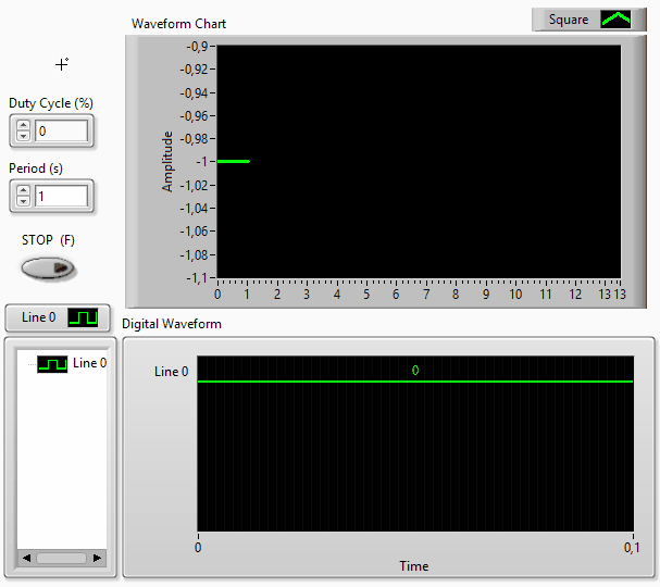

The DAQ Assistant doesn't provide a built-in functionality to output a PWM signal on a DAQ device. As a result, additional functions must be integrated along with the assistant in a VI to provide this functionality. The VI could be configured as follows:
The example code shown above combines three main functions:
  1. DAQ Assistant vi
  2. Simulate Signal vi
  3. DWDT Analog to Digital vi
The logic behind the program goes as follows:
  1. A square analog waveform is generated using the Signal Simulator Express VI
  2. An analog to digital conversion with 1bit resolution is performed using the Analog to Digital VI
  3. A 1D array of a Digital Waveform is created and inputted to the DAQ Assistant.
The DAQ Assistant is internally configured as follows:
  • Digital Output
  • Continuous Samples
  • Samples to Write = 100
  • Rate = 1kHz
The example code's functionality is shown on the image below:
