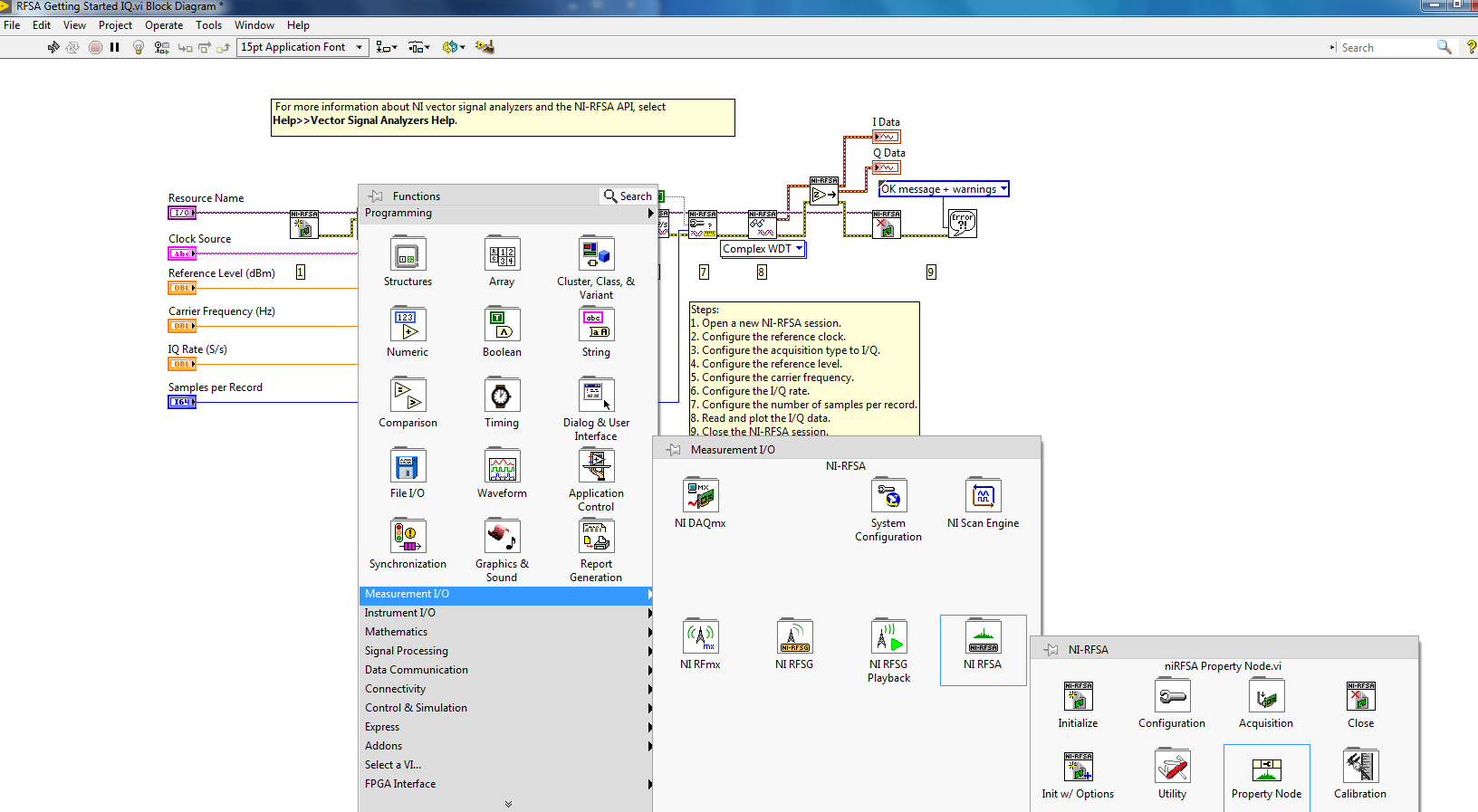

  • Using niRFSA Property Node:
    • In LabVIEW, you can use the niRFSA Property Node to get the device specification from the populated choices.
      1. Open LabVIEW and run any shipping example involving the niRFSA.
      2. Insert Property Node from the NI-RFSA pallet.

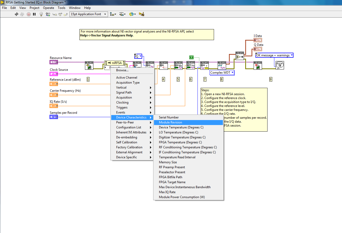

      3. Choose Device Characteristic and select which specifications you want to check on.
