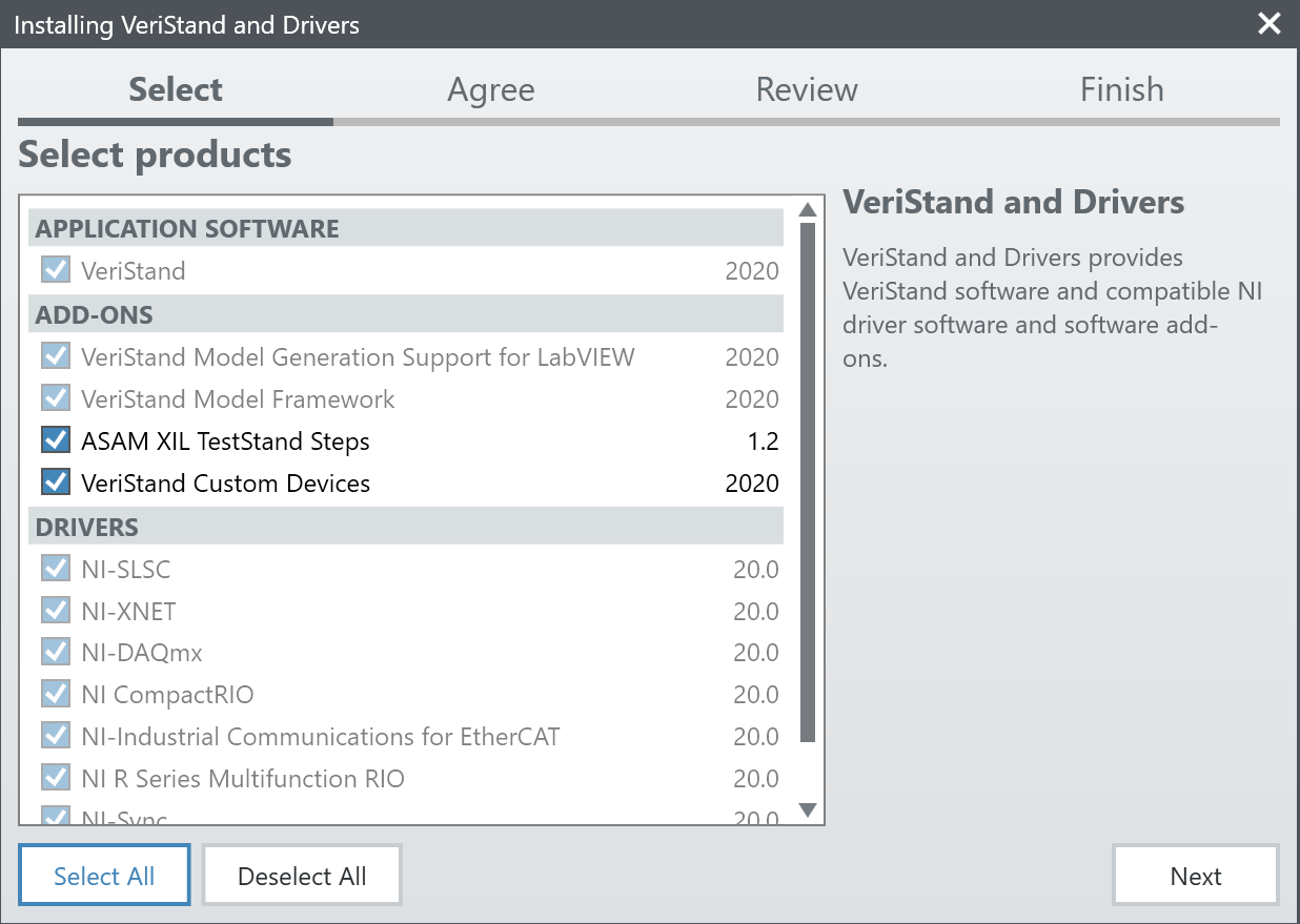

  1. Install VeriStand from the VeriStand DVD, NI Package Manager, or VeriStand Web Download.
  2. Select the components needed for your application, including Add-Ons and Drivers.
Note: For machines that do not need the VeriStand environment, select only the VeriStand Model Framework for installation. The VeriStand Model Framework can be installed independently and licensed for free. Once you have installed the VeriStand Model Framework, you can license it for free by using the serial number S14X86758.
  • Application Software: VeriStand
  • Add-Ons (Optional):
  • VeriStand Model Framework: Adds support for building simulation models in third-party environments such as MathWorks Simulink®* simulation software and ANSI C.
  • VeriStand Model Generation Support for LabVIEW: Converts a LabVIEW VI into a simulation model for VeriStand.
  • ASAM XIL TestStand Steps: Sets of custom steps that allow you to reuse test sequences developed for other hardware-in-the-loop (HIL) systems that use the ASAM XIL API.
  • VeriStand Custom Devices: Includes various custom devices that NI supports.
  • Drivers: Drivers needed to interface with hardware.
Figure 1. Installing VeriStand and Drivers

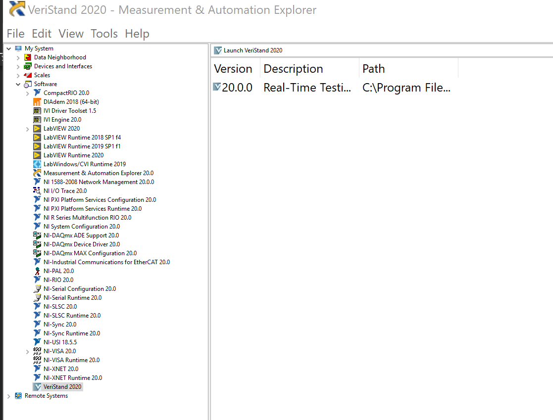

  1. After all installations are complete on the host PC, open NI Measurement & Automation Explorer (MAX) to confirm the installed software by expanding the My System » Software item within the tree structure as shown in Figure 2.
Figure 2. NI MAX

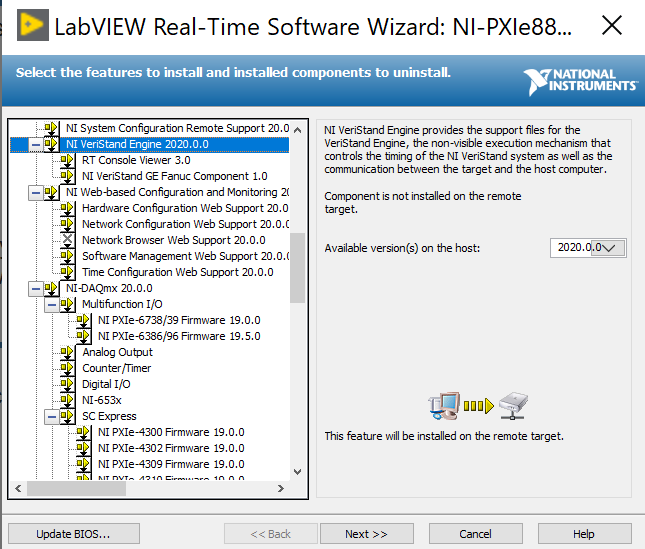

Figure 3. Installing software to Phar Lap target
  1. Choose to install the VeriStand Engine. This installs the VeriStand Engine as well as the software components required to run it.
  1. Optional: To implement a distributed real-time test system that uses GE reflective memory interfaces, select the GE reflective memory software on the target to install.
  1. Optional: If you are using a CompactRIO device and want to install the Scan Engine Custom device, select the NI-Industrial Communications for EtherCAT and I/O Variable Remote Configuration Web Service to install.
  1. Complete the software installation process and reboot your real-time target. You can see a list of currently installed software on your target by looking under Remote Systems»Real-Time Target»Software within the MAX tree structure as highlighted in Figure 3.

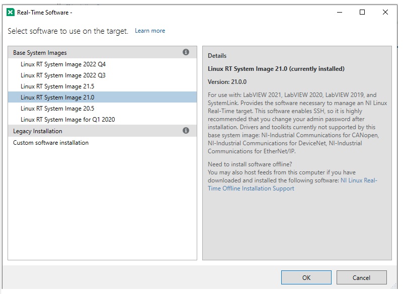

  • NI Linux Real-Time
  1. If the controller does not have internet access, install NI Linux Real-Time Offline Installation Support on the host computer, and follow the steps in Installing Software to Offline NI Linux Real-Time Targets.
  2. If the controller has internet access:
    1. Select your target, right-click it, and select Format Disk.

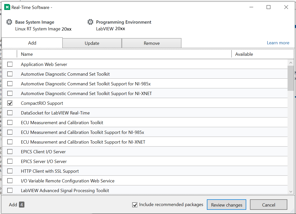

    2. Select your target and choose Add/Remove Software. Apply the Base System Image that corresponds to your VeriStand version.
      For example, the minimum Linux RT System Image that can be used with VeriStand 2020 R6 is 21.0.
Figure 4. Installing Linux RT System Image

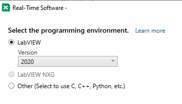

  1. Select LabVIEW as the programming environment. The LabVIEW functionality in VeriStand always requires like-numbered versions. For instance, if using VeriStand 2020 R6, LabVIEW 2020 must be selected.
Figure 5. Selecting programming environment

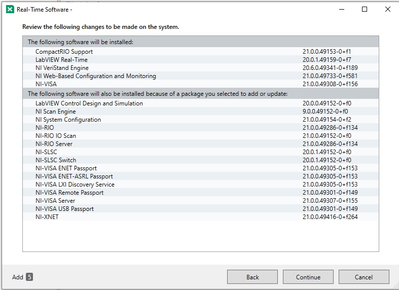

  1. Select the specific software components to install on the target. Review Changes and then click Continue
Figure 6. Select software components to install

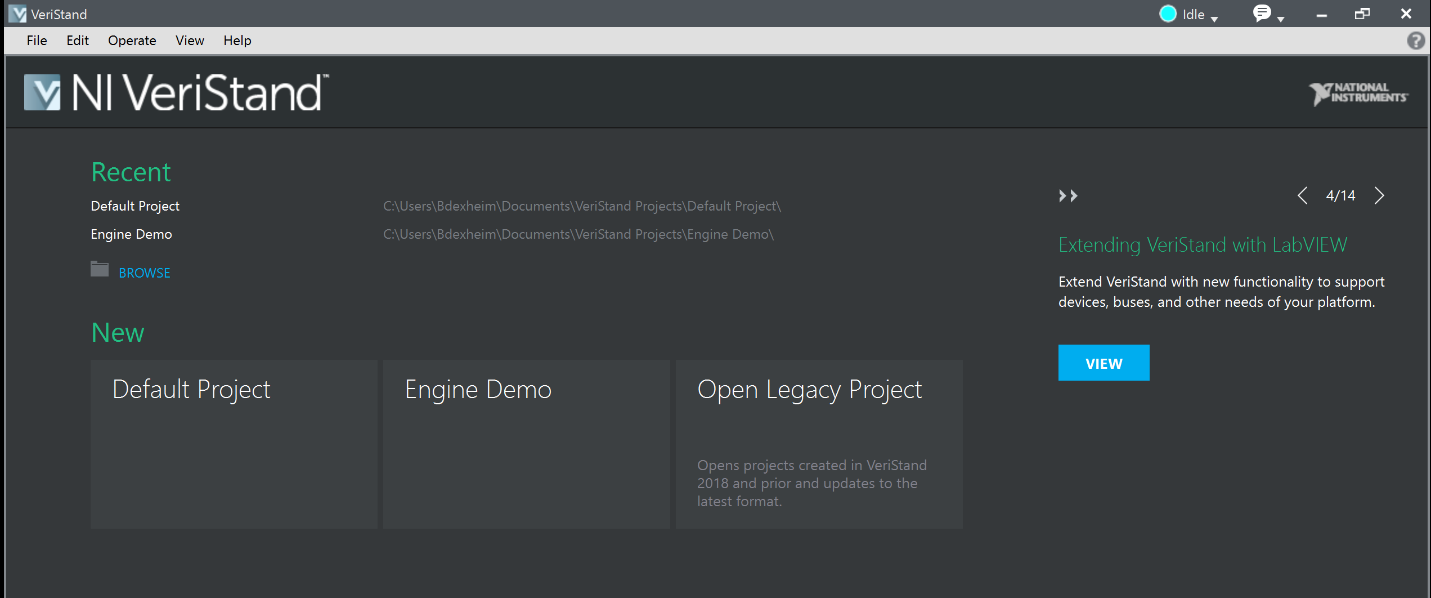

For an example of a configured VeriStand Project, click Engine Demo under New.
To open a new VeriStand Project, click Default Project under New. Choose your project name and directory path from the window that appears.
Note: NI recommends keeping all project dependencies relative to the project file location and placing them in the same folder or subfolder. This includes items such as Workspace files (.nivsscren), System Definition files (.nivssdf), Stimulus Profile files (.nivsstimprof), Real-Time sequence files (.nivsseq), models, and FPGA bitfiles or configuration files.
Figure 7. VeriStand Launch Screen

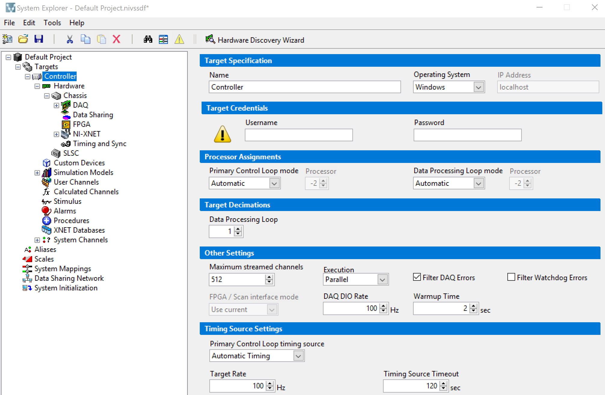

Select Deployment Targets
Note: The Operating System drop down has the choice for Phar Lap*, Windows, Linux_32_ARM, and Linux_x64 as of VeriStand 2020. The choices for VeriStand will match the Real-Time Controllers and RTOS Compatibility documentation.
There are 2 ways you can select and configure a deployment target:
  1. Follow the Specifying a Target section in the VeriStand Manual.
  2. In System Explorer by:
  1. Highlight Controller in the tree
  2. Select target operating system for the OS
  • If running VeriStand Engine on the Localhost Windows Computer, select Windows for the OS. The automatic selection for IP address is localhost, which indicates that the System Definition runs on the host PC. Skip to step 4.
  1. Use the same IP address displayed for the target system in MAX
  2. Rename the controller Name to a unique name of your choosing
*NI removed support for Phar Lap for CompactRIO in the NI 2020 Software Release and for PXI in the NI 2022 Software Release. For more information, please see the Phar Lap RT OS EOL Road Map .

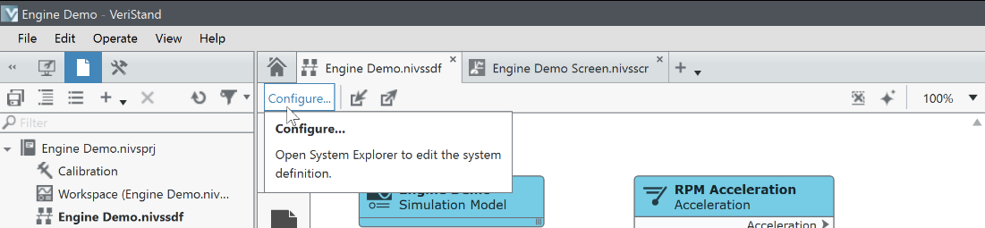

Configuring the VeriStand Engine Using System Explorer
Once a new VeriStand Project is open, press the Configure button to open the System Explorer so you can edit the System Definition.
Figure 8. Configure to Open System Explorer
  1. Once in the System Explorer, navigate to the Controller section.
  2. The setting for Target Rate underneath the Timing Source Settings section sets the Primary Control Loop rate on your target. The Primary Control Loop controls the timing for the VeriStand Engine and keeps updated channel values. Find more information on the Primary Control Loop and other individual loops running on the VeriStand Engine in VeriStand Engine Architecture .
  3. Expand Controller in the tree and note the various items you can add to your System Definition.

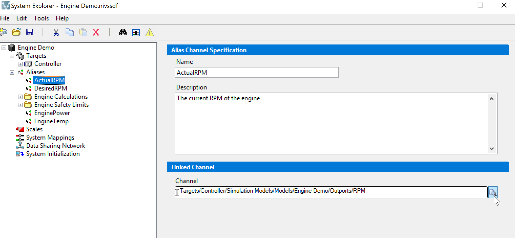

  • Aliases: Configure an alias to give a channel or group of channels a unique name in your system definition.
  1. Right-click on Alias and select Add Alias.
  2. Type in the desired alias Name and Description
  3. Click the Browse button next to the Channel to select the channel to rename.
Figure 10. Aliases

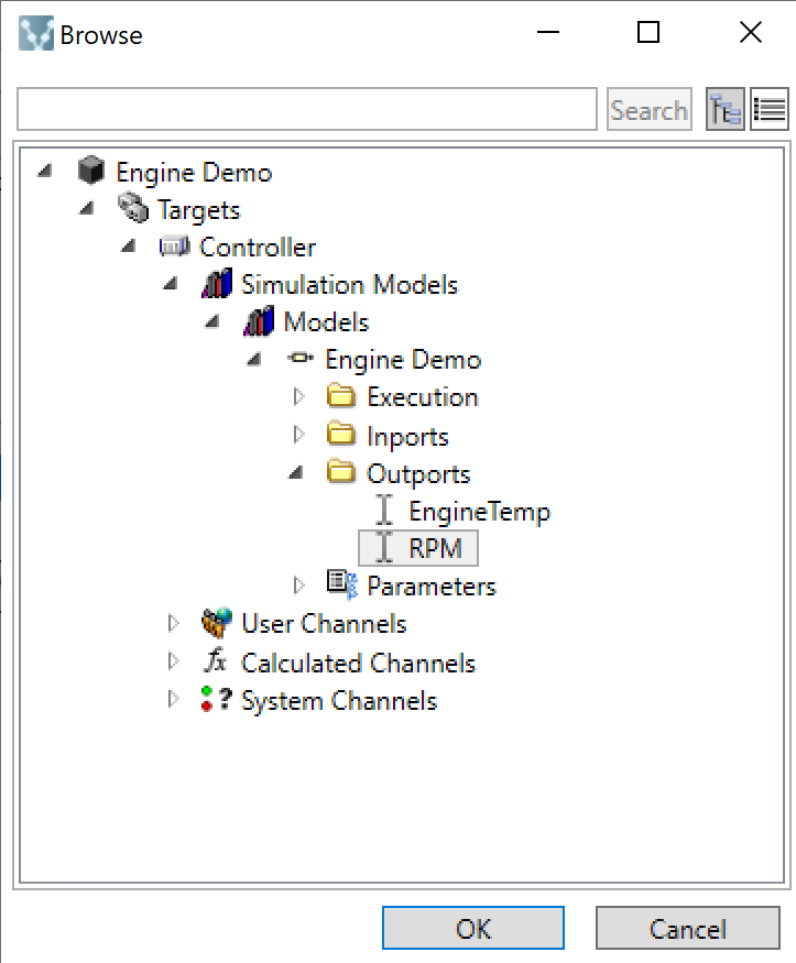

  1. Use the Browse dialog box to select your channel.
Figure 11. Browse for linked channel
  1. Selecting an alias instead of its linked channel path will decrease the frequency of link errors. Updates to the linked channel path will not affect the alias name.

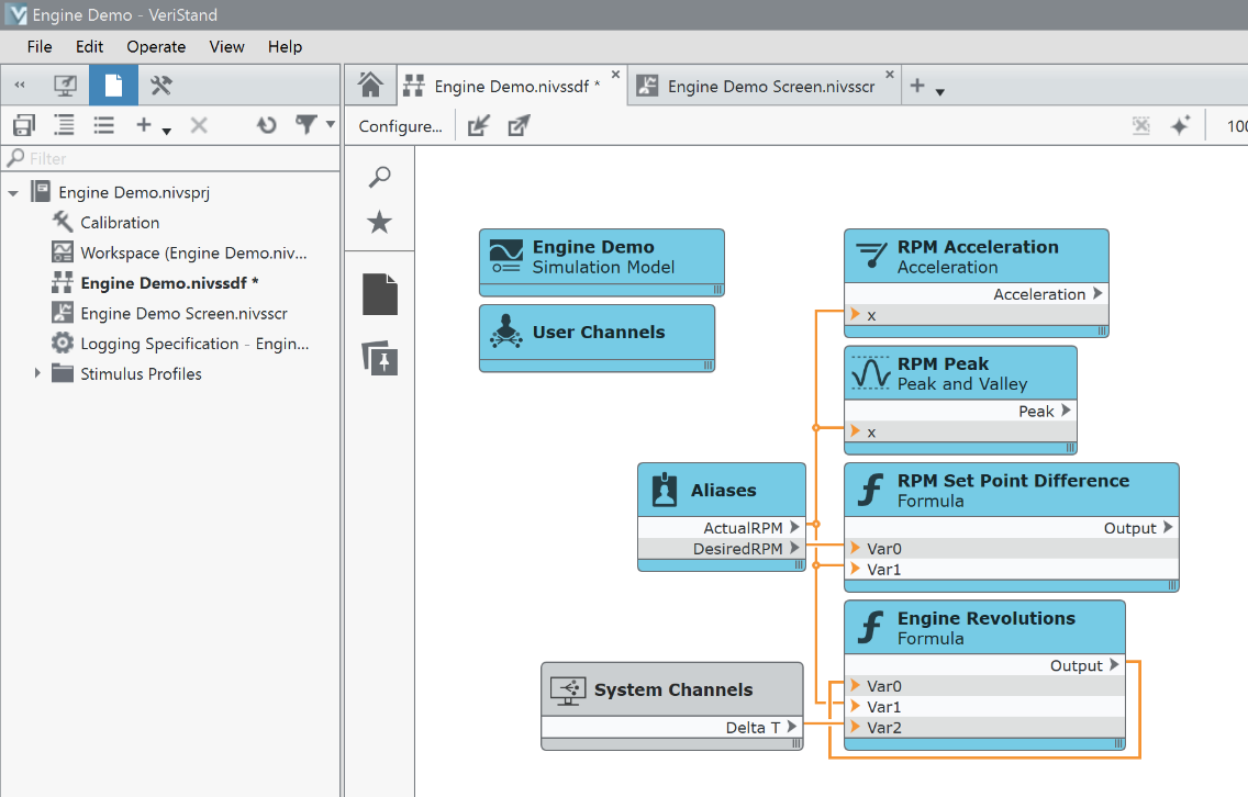

Mapping and Inserting Channels with the Mapping Diagram
Figure 12. Mapping Diagram
Connecting Channels
As of VeriStand 2019, you can use the Mapping Diagram to connect channels to each other to visualize mappings. To connect channels:

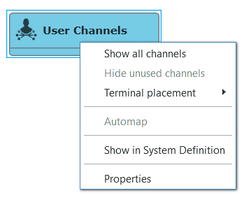

  1. If the Node is collapsed (i.e. User Channels and Engine Demo Simulation Model in Figure 12), right-click the node.
Figure 13. Menu when right-clicking a Node

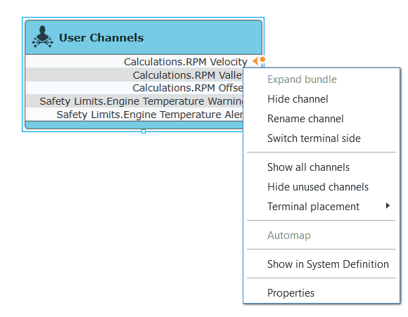

  1. Click Show All Channels expand channels
Figure 14. Menu after channels are expanded
  1. Wire and map to other channels in your system

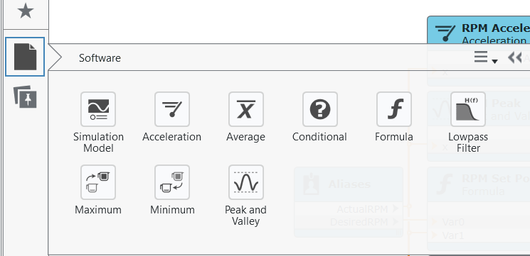

Inserting Simulation and Calculated Channels
In VeriStand 2020, you can use the Mapping Diagram to insert Simulation Models and Calculated Channels. To do so, click the doc icon on the left to give the options and click on the desired channel to be inserted into the Mapping Diagram.
Figure 15. Channels List for Inserting into Mapping Diagram

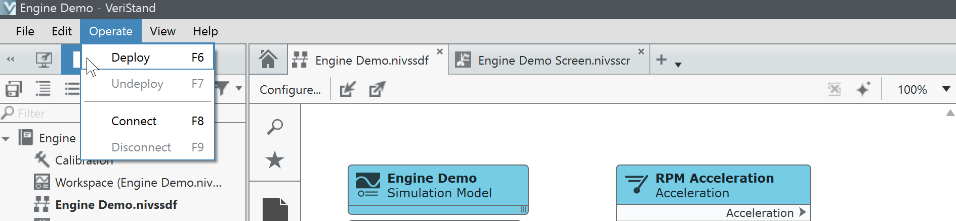

Deploy VeriStand Projects
Once you have configured your system definition, save and close System Explorer. You can deploy your system definition.
Figure 16. Deploy VeriStand Project

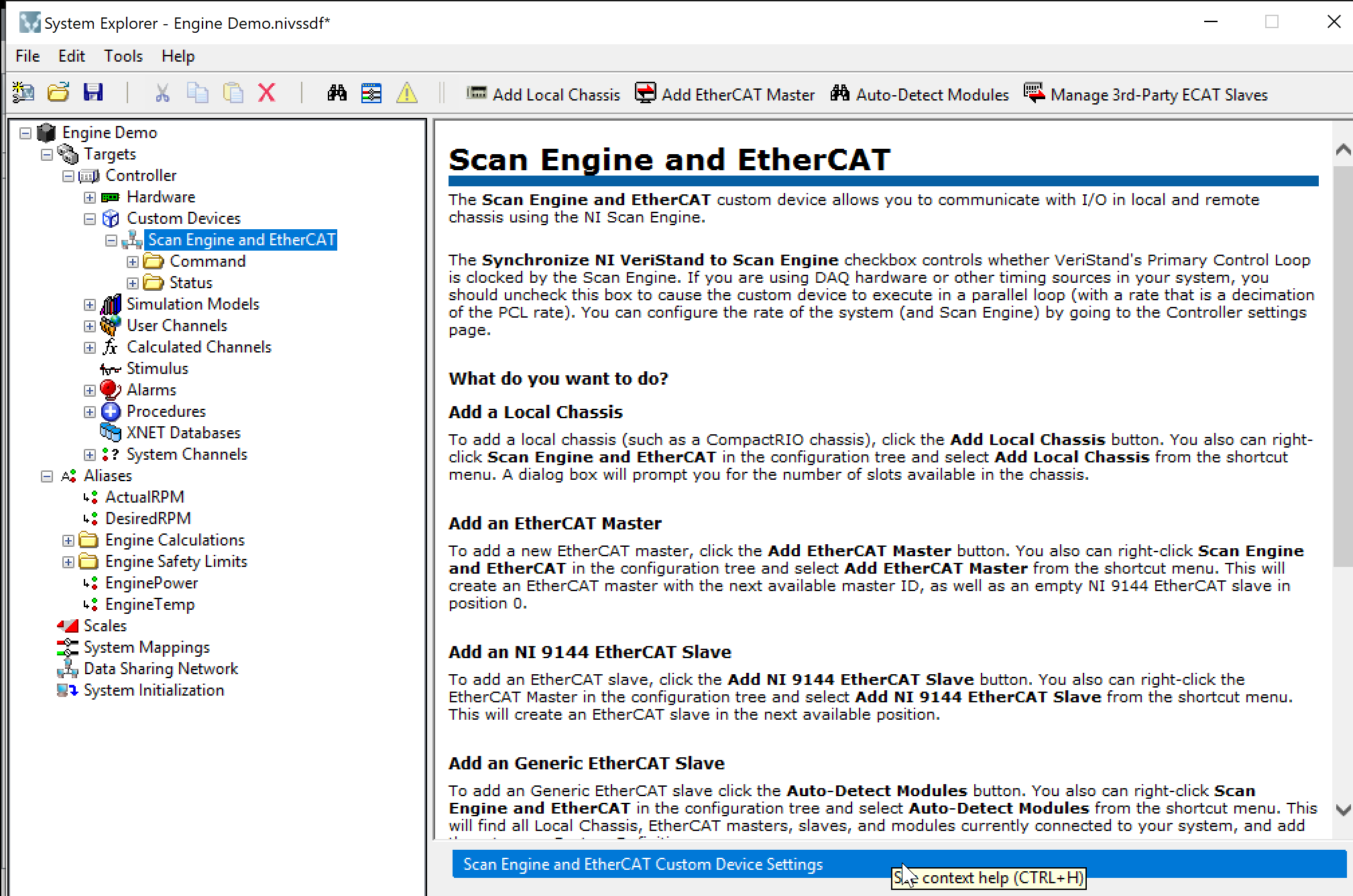

Use the EtherCAT and Scan Engine Add-On for VeriStand
With the Scan Engine and EtherCAT custom device, you can read scanned I/O from C Series modules located in a CompactRIO or NI 9144 EtherCAT chassis. The add-on also supports the use of custom FPGA personalities with an NI 9144 chassis.
Note: The EtherCAT and NI Scan Engine add-on for VeriStand is compatible with CompactRIO targets and the NI 9144 EtherCAT expansion chassis.
You can install the Scan Engine and EtherCAT Add-On in the VeriStand installer. Otherwise, you can download and install from GitHub.
To add the Scan Engine and EtherCAT Add-On to your VeriStand system, follow these steps:
  1. Launch the VeriStand Editor.
  2. In the Project Files pane, double-click a system definition file (.nivssdf). System Explorer opens.
  3. Expand Targets » Controller » Custom Devices in the configuration tree.
  4. Right-click Custom Devices and select Scan Engine and EtherCAT.
  5. Select Auto-Detect Modules. Alternatively, right-click and select Add Local Chassis to use CompactRIO chassis and manually choose the appropriate module for each slot and correct settings for each module.
Figure 17. Scan Engine and EtherCAT Custom Device
