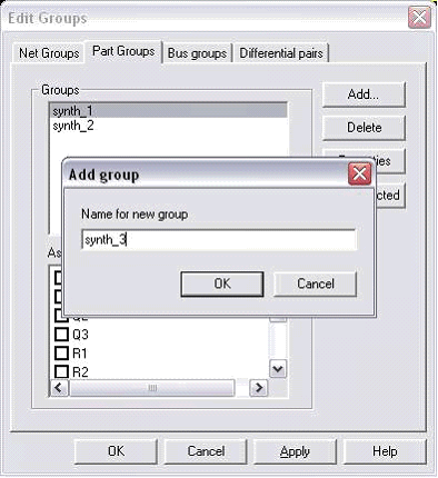

Create a Unique Group in Ultiboard
The first step is to create a unique Ultiboard Part Group which represents each PCB module (in this example we would need 8 seperate Part Groups, to represent each digital synthesizer module). A Part Group effectively creates an association between various components in a design and allows you as a designer to give this group a unique identifier.
We can now create a unique group for each PCB design module.
  1. Select Tools >> Group Editor...
  2. Select the Part Groups tab
  3. Click on the Add button to begin defining uniquely named groups
  4. Type the name of the Part Group. In figure 1 you will notice we have named our groups synth_X, where represents a number between 1 and 8 (for the eight synthesizer modules).
  5. Type synth_1. Click on the OK button.
  6. You will be presented with a Change group settings dialog box. Here you can set specific information on component spacing, clearances to traces, pin swapping etc... In this example we will select the default settings.
  7. Click on the OK button.
  8. Repeat for all groups in your design
Figure 1: Creating a Part Group

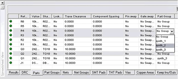

Method 2
Another method that one can use, that further simplifies this part association task is to the use the Spreadsheet View in Ultiboard. Ultiboard is a tabular representation of all components within the workspace. It effectively captures all pertinent information about components and trace on a design (name, value, spacing, pin properties) in one simple, easy-to-use interface. The Spreadsheet View also allows you to view the Part Group that each component is assigned to within a design. Therefore we can use use the Spreadsheet view.
  1. Close the Edit Groups dialog box by clicking first on Apply and then OK.
  2. Select View > Spreadsheet View to see the Spreadsheet View.
  3. Select the Part Group tab in the Spreadsheet View.
  4. Navigate to the Part Group column.
  5. For each component you can now click in the Part Group column to reveal a list of all of the available Part Groups. Select the Part Group for that particular component (for example synth_1) as seen in Figure 2.
  6. Repeat for all components that belong to a particular part group.
Figure 2: Using the Spreadsheet View to Assign Parts

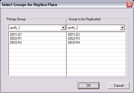

With the first group (synth_1 for example) completed we can begin replicating the careful placement and routing for all other groups in the design. Basically what we can do is take the placement (part orientation) and exact copper routing configuration and apply them to the other part groups that we have defined.
  1. Select Design >> Group Replica Place.
  2. In the Primary Group section select the first group, which you have already completed placing and routing (for example synth_1).
  3. Select a Secondary Group, for example synth_2 (as seen in Figure 3).
  4. Ultiboard has automatically assigned the placement of synth_1 to synth_2.
  5. Click on the OK button. The Parts Group will automatically become attached to your mouse cursor.
  6. Move the attached Parts Group to the appropriate location on the Ultiboard work area.
  7. Repeat these steps for all other groups, and replicate the appropriate placement
Figure 3: Group Replication

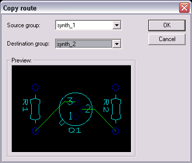

We can now begin replicating the copper traces for each of these PCB modules or Part Groups and apply it to another group.
  1. Select Design > Copy Route.
  2. In the Copy Route dialog box select the Source Group (one which has already defined the copper traces - for example synth_1) and a destination group to replicate the traces (for example synth_2) as seen in Figure 4 below.
  3. Click on the OK button.
  4. Repeat for all other Part Groups.
Figure 4: Copy Route
