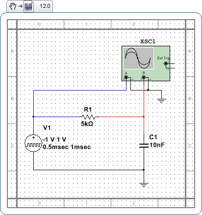

The figure below shows an example of a Multisim Selection Snippet for a basic RC circuit. Notice that the border is a hashed line. Try it out now! From this document, simply drag and drop the snippet into a design schematic of the Multisim environment. Once the circuit appears on the Multisim clipboard, you can left-click to place it on your design. If you do not have a design schematic open, Multisim creates the design for you and automatically places the components. The location of the placement is not guaranteed.

The figure below shows an example of a Multisim Design Snippet for the same RC circuit. Notice that the border is a solid line. Try it out now! From this document, simply drag and drop the snippet into a design schematic of the Multisim environment. Multisim creates a new design with the circuit already placed.
