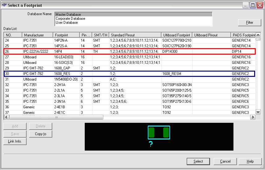

To understand how Multisim maps its database components to real and generic PADS footprints, view the Select a Footprint dialog box (Figure 1). Notice that for the IPC-2221A/2222 component (figure 1, red box), the PADS Footprint column contains the name of a real footprint, the DIP14. Conversely, the IPC-SMT-783 component (figure 1, blue box) is mapped to a generic PADS Footprint (GENERIC2) which has two pins but is not necessarily a commercial footprint.
Figure 1: Select a Footprint

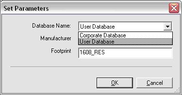

  3. In the Set Parameters dialog box set the Database Name to User Database (figure 2)

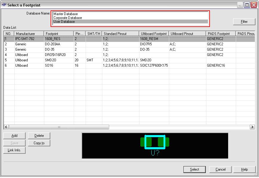

  4. As you return to the Select a Footprint dialog box, set the Database Name field to User Database.
  5. Select the name of the footprint, and left-click once in the PADS column
  6. Type the name of the real PADS footprint in the column (this name will exactly match the name of a footprint available in the PADS database).

Figure 2: Set Parameters
Figure 3: Re-map Footprint

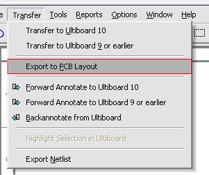

  2. Select Transfer >> Export to PCB Layout (Figure 4)

Figure 4: Transfer Menu
