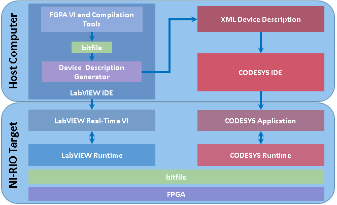

The following diagram demonstrates the flow of data between software and hardware components for deploying a CODESYS application to an NI Linux Real-Time target.
![](/servlet/rtaImage?eid=ka03q000000lUM5&feoid=00N3q00000HUsuI&refid=0EM3q000001JKeh)
Figure 3: Data flow for the LabVIEW FPGA IEC 61131-3 Interface Utility
The following list describes the components in the diagram:
Host Computer—The computer that runs necessary software components.
LabVIEW IDE—The IDE you use to develop and manage VIs.
FPGA VI and Compilation Tools—The FPGA VI is the VI that defines the I/O of the NI Linux Real-Time target. The LabVIEW compilation tools translate the FPGA VI into binary data that you can download and run on the NI Linux Real-Time target.
bitfile—A compiled version of the FPGA VI.
Device Description Generator— Tools that generate a custom device description for the CODESYS IDE to access the I/O of the NI Linux Real-Time target.
XML Device Description—An XML file that contains information about the controls and indicators in the FGPA VI.
CODESYS IDE—The IDE you use to build and deploy CODESYS applications.
NI Linux Real-Time Target—NI Linux Real-Time hardware that runs the code you create with LabVIEW and CODESYS.
LabVIEW Real-Time VI—The VI that runs on the NI Linux Real-Time target and communicates programmatically with the FPGA VI.
LabVIEW Runtime—The LabVIEW Run-Time Engine that includes the libraries and other files necessary to run basic application types built in LabVIEW.
CODESYS Application—The executable control program you deploy to the NI Linux Real-Time target using CODESYS.
CODESYS Runtime—The CODESYS runtime system that offers functions for the NI Linux Real-Time target to communicate with the CODESYS programming system.
bitfile—A compiled version of the FPGA VI that you download to the NI Linux Real-Time target.
FPGA—Reprogrammable chips.
