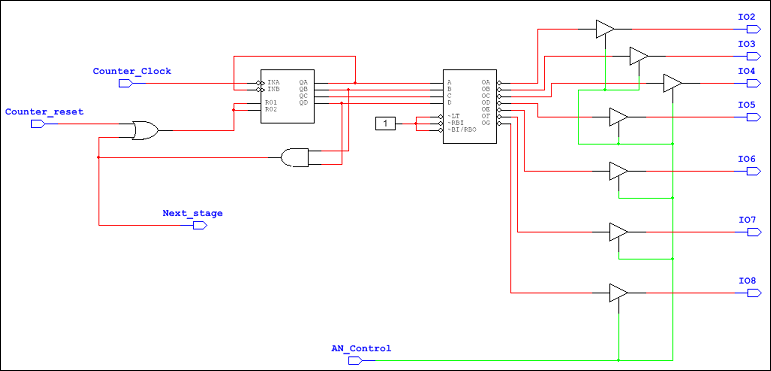

Each of the four display counter blocks are represented by a subsheet containing:
  • A counter that calculates the value for that display before passing that value onto the next display counter block.
  • A 7-segment decoder to take the counter value and output it to the display.
  • A buffer for each of the seven lines leading to the display.
